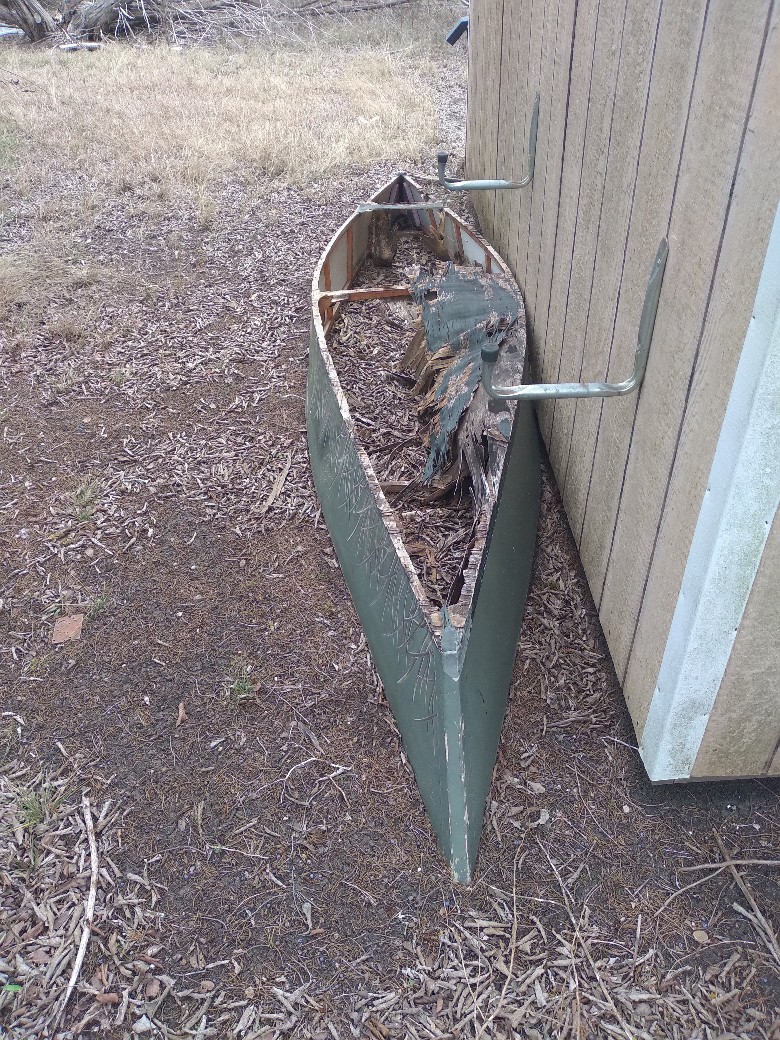

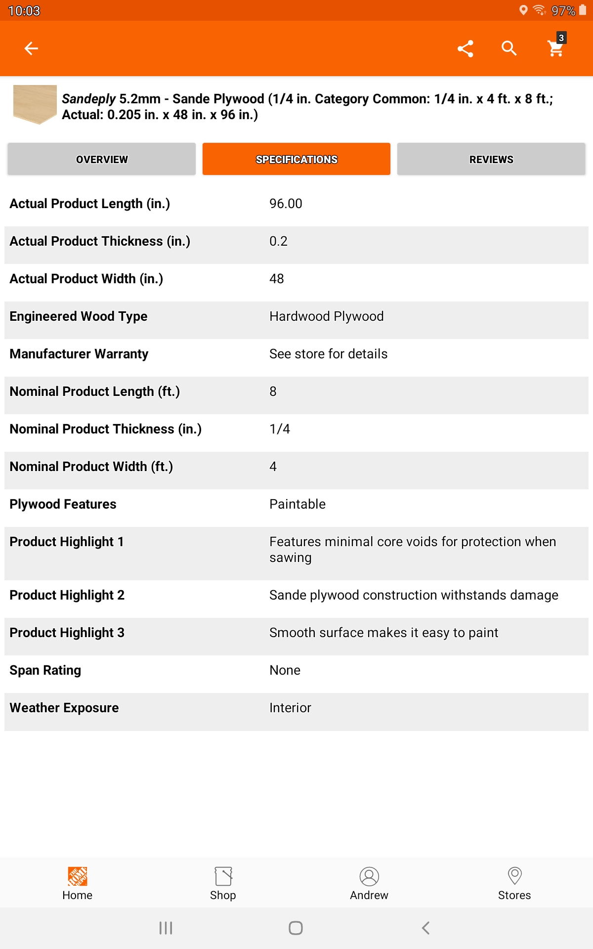

Terry, sorry I'm late with this, maybe old age or I wanted to forget it! This boat was made about 4 years ago, floor of sande ply 5.2 mm.saturated both sides of the floor with several coats of epoxy, no glass. it statrted to delaminate, I didn't care much for its stability so I just set it out side, maybe 3 years ago.
1534

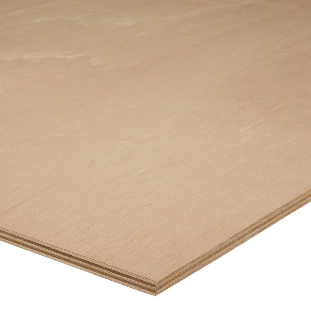

Rated exterior. I believe Joey has used this?
Rated interior.
"Sanded" plywood not the same as "Sandeply".

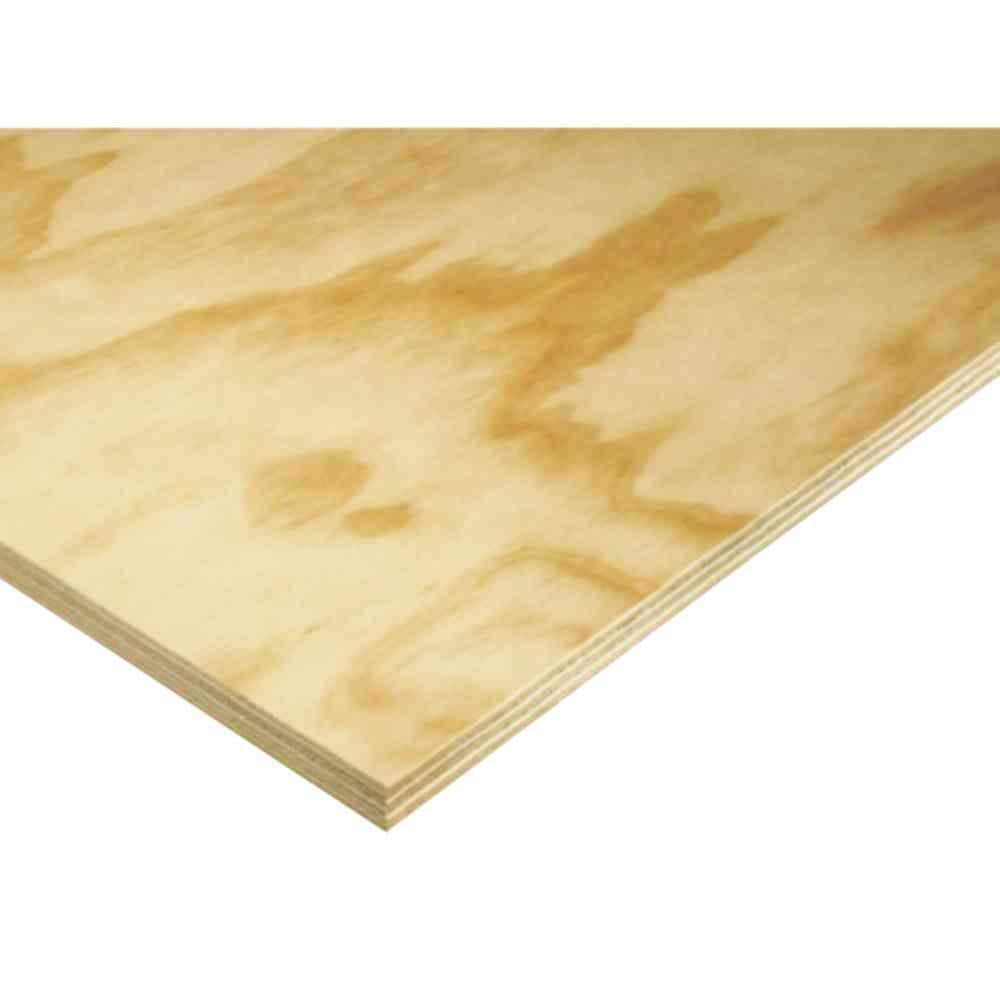

Rated interior.

I've used the sanded pine plywood on 3 boats. I found the tools worked better on it than on fir marine ply. It also had way less surface splits than fir. I never found many interior voids if I took my time and looked through the stacks. I wouldn't use fir now even if it was the same price..........and it's definitely not! Pine ply is a bit heavier and maybe not as pretty as some high-priced ply, but it pairs well with a simple pirogue. I'd guess you would gain 7-10 lbs in a boat built with it over a quality albeit, thinner ply.
