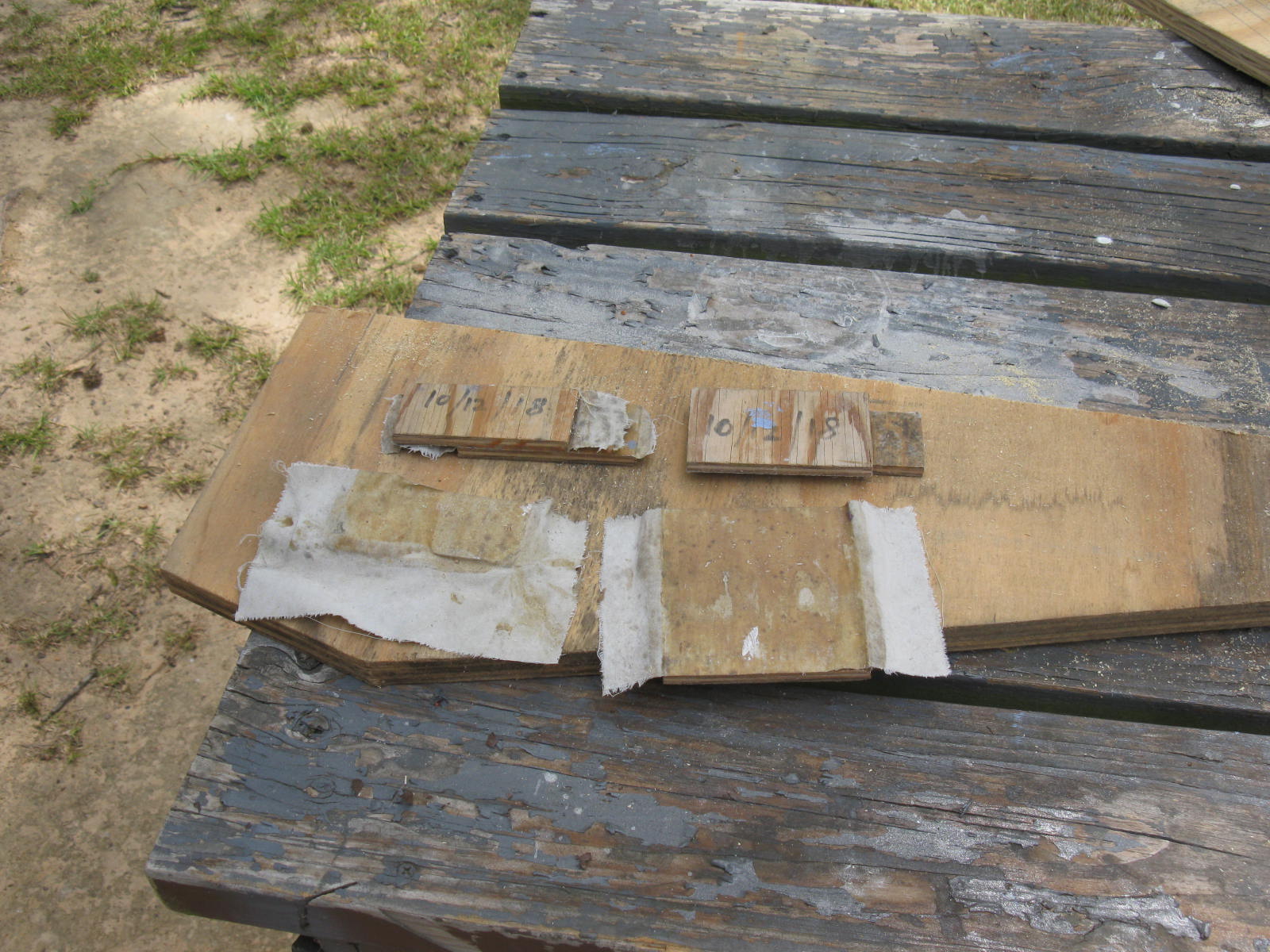

Test are ongoing. These samples were glue up in Oct. 2018 and were left outside on the ground. Picture was taken 8/8/19 but little change since. No delamination or rot in the coated cloth or wood. Pretty impressive to me for unpainted bed sheets and pine plywood.

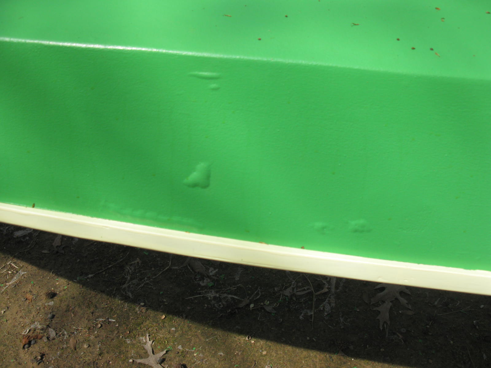

After sitting the boat in the sunshine many bubbles appeared under the cloth. This is not an issue with the paint. The glue has released from the wood and fabric. I do not know why.
I did have issues with drying because of the weather. Perhaps it failed to bond because of the long drying time, or because the glue was not under pressure while drying.
At this point I plan to use the boat as is. Even if the cloth fails the boat will still function.

Looking close up at those blisters, I can tell you that paint is not the problem. The paint held; the surface is not broken, it is still integral. The problem is something causing pressure UNDER the paint. A likely culprit is moisture. Moisture could contribute to both poor surface adhesion and gas pressure.

Jack that is my assumption and most likely the cause. Worst weather possible for building damp and cold. I foraged ahead and now I'm paying the price.
Despite the problems I think PMF may be a workable choice. It will not replace epoxy and fiberglass but could be an alternative with limitations. More will be learned with usage.

The coat looked robust; it was withstanding the pressure from underneath. I think that, under the right conditions of application, it could be a viable system.

Guys don't be too hasty to decide based on my results. You have to factor in my ineptness and lack of experience working with it. I am 99% sure the problem was caused by the extremely damp weather. The inside of the floor was done some time before the outside with no issues.
I will say fiberglass/epoxy is no harder to do if you are familiar with that process. I actually used 3 coats of glue (almost 2 gal.) to completely fill the weave, so this decreased the cost difference some. Probably could have gotten by with 2 coats and then finished the filling with paint.
My efforts were not successful but others have reported it to work. I would not use it for a design that needs the cloth as a structural component. It may offer a choice as a surface coating/fairing, but little need for that. Canvas canoe builders pretty much have that process down pat. The concept probably falls in the "It works, but why would you?".
