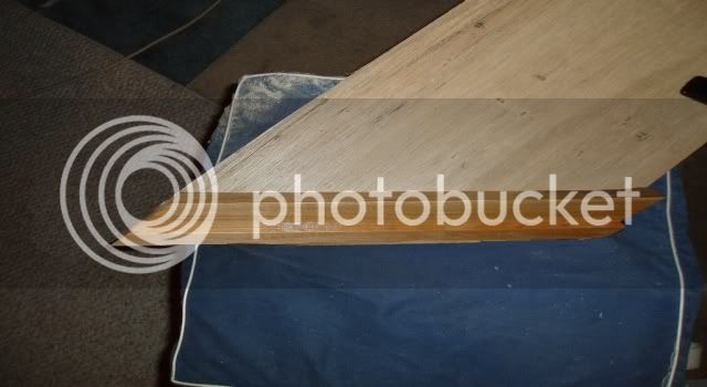

I'm in a fog (pun intended) about the position of the sides on the stem and stern pieces for an Uncle John's pirogue. Is it right to move the side down to the bottom of the stem piece so that the bottom of the side ends where the narrower piece of the stem meets the wider piece like this?
http://i155.photobucket.com/albums/s283 ... tern00.jpg
Thanks in advance for responding. With epoxy and screws in this step I absolutely can't mess this step up!
VTFogg
VTFogg
Jan 14, 2007
73
Rutland, Vermont
Ok, I'm revealing my ignorance, but here goes. The stem and stern are provided in Uncle Johns kit. They are symetrical. Here is a picture:
<a href="http://photobucket.com" target="_blank"><img src="http://i155.photobucket.com/albums/s283/VTFogg/Positioningthesidesonthestemster-1.jpg" border="0" alt="Photobucket - Video and Image Hosting"></a>

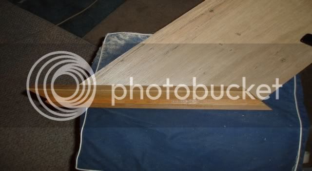

That said, I am confused by upside down. Do I simply mount on the other side of the board like this?
<a href="http://photobucket.com" target="_blank"><img src="http://i155.photobucket.com/albums/s283/VTFogg/Positioningthesidesonthestemster-2.jpg" border="0" alt="Photobucket - Video and Image Hosting"></a>

Hi VTFogg,
You had it in place like this (your pic shrunk a bit):
Try turning it over and flipping it untill it fits like this:
That should do it!
Think of it as an arrowhead , the pointy part goes forward while the wider part is towards the boats center. Then if the flat part (the bottom ) of it lines up with the bottom of the sideboard , it is correct.
It should be at a 45 degree angle from center facing forward away from the boat as in the picture stevesteve posted above.

Many thanks stevesteve, and all others. Seems rather obvious now, and am feeling rather foolish. :roll:

Hi VTFogg,
No problem. Foolish is how you should feel if you had stuck it in place without asking.
