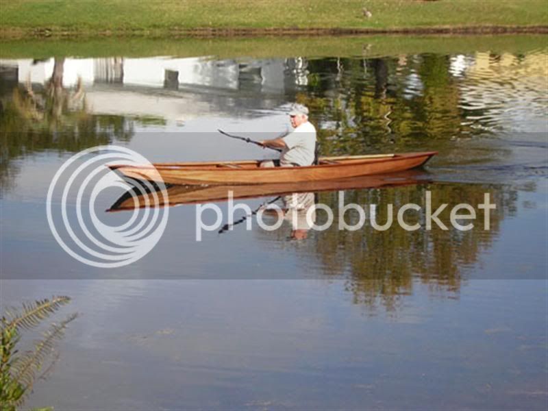

Paddled the first time in the retention pond across the street.
I've not done much paddling before but sure looking forward to fishin with her real soon. I built her for the no-motor zone in the Banana River plus ?.

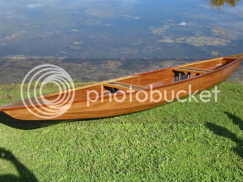

The boat looks better in the pictures than it really is. I'll call it a 10' boat. Looks better and 10' than up close. It's that way on purpose. I could have put forth a little more effort in sanding and so on to make it really nice but I really use my boats and it'll get beat around a bit. I don't like spending to much time in sanding off perfectly good epoxy and then go and get it scratched up anyway. It's one of my fishing boats not a show piece I have to worry about.
The black on the bottom is epoxy and graphite. Ply is 3/16 Okume glassed inside and out with 6 oz fabric.

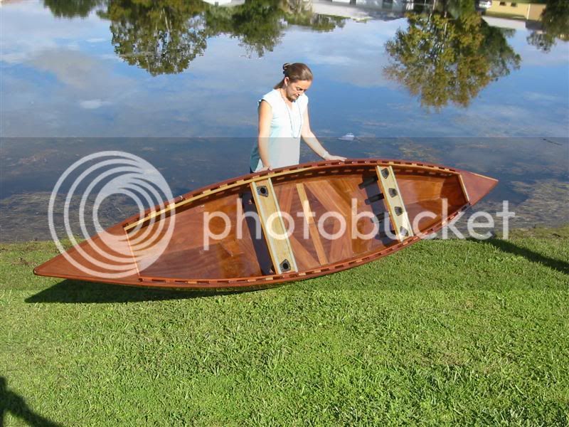

If you dont mind my asking. What were the processes for the inlaid bits on the bottom?

Mick, the wood you asked about is not inlay. It's 3/16 ply pieces that are epoxied to the bottom on the inside. I used butt blocks for the ply splices and this made it easy to blend the bottom center one in and add some support for the center area. They are like Chuck used for his except mine are not running length wise.
