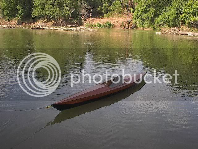

Look at the pics.

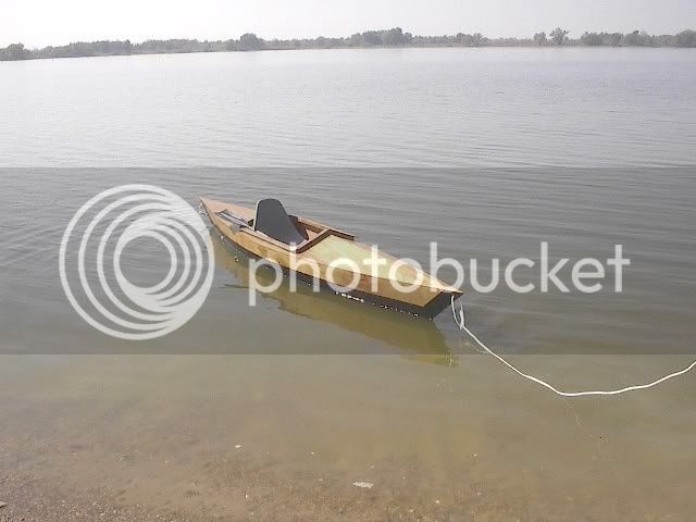

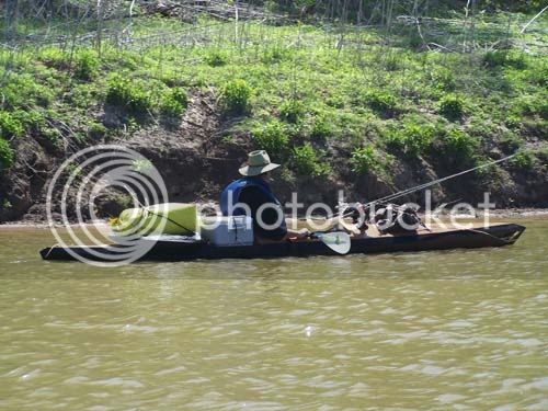

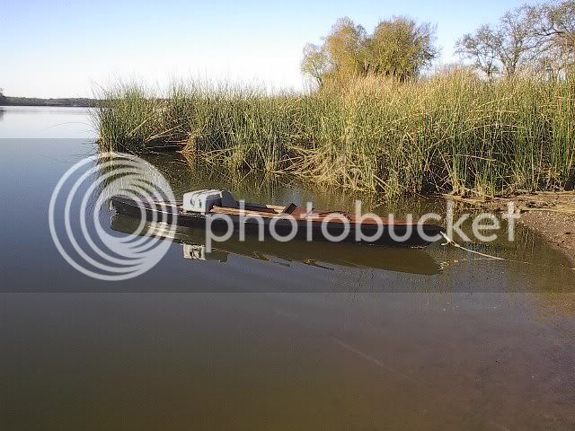

Interesting. Image# 1 shows a loaded boat, not an empty boat. Image# 2 looks like it's floating about even, but both ends aren't visible. Image# 3 looks about even, but, again, both ends can't be seen. Image# 4 looks like it's grounded. What was it these pictures are supposed to indicate? You lost me here, Ron.
Wrong again Jack non of the boats are loaded or grounded ,I am not posting this to argue with you . In my opion you are wrong so I stated mine.
Ok Jack Here we go ,that boat was designed around that cooler ,wich empty might weigh a couple lbs. so the rocker of the boat was set for it. no different than a deck running up that far.

Here is a pic of the T-V with around 500 including me in her .she still has the same trim as an empty T-V

but i do believe that once the bottom of the front stem is underwater, as shown in Ron's pic with the boat loaded, amount of rocker becomes pretty insignificant
