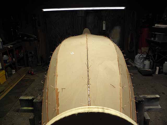

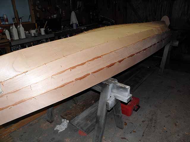

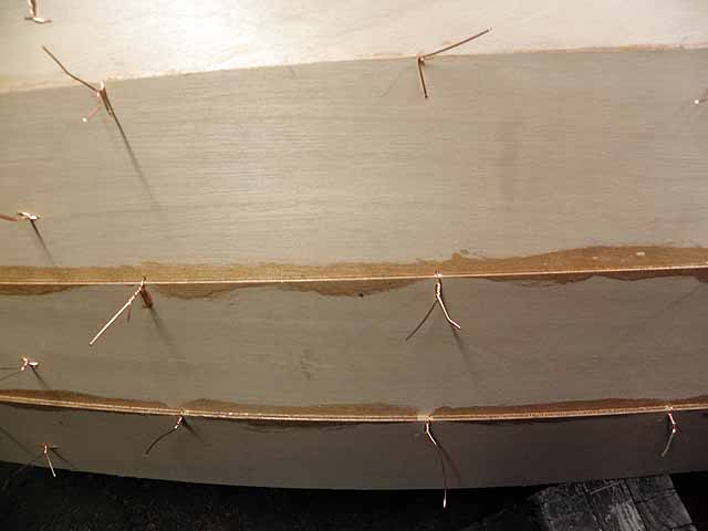

Finished stitching all the panels and epoxied all the outside joints. This is a big canoe! Length 15' 7", Finished weight 68 lbs., Beam 39 in. Max. Weight 500 lbs. It is fairly a flat bottom (center).
