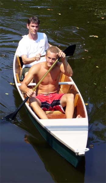

Like you , I have seen some big guys in a pirogue but never two of them , two pirogues with one person in each but not two in one when out paddling. One reason might be because we always have the boats packed with camping gear.
On Uncle Johns web site www.unclejohns.com/ if you click on the pirogues and then go down to the Pictures from builders and flip threw the pictures he has some of two guys in one boat , even two guys and a gal in one of them. All the boats are the standard 15 1/2 foot ones. :D
Here is one of them

O Master of Flow Bizness,
That pichur will likely give Mark the best advice of all. He kin pichur him 'n hiz buddy in that pirogue. That fella in the front looks like 5' 9" 150 pounds. :wink:
