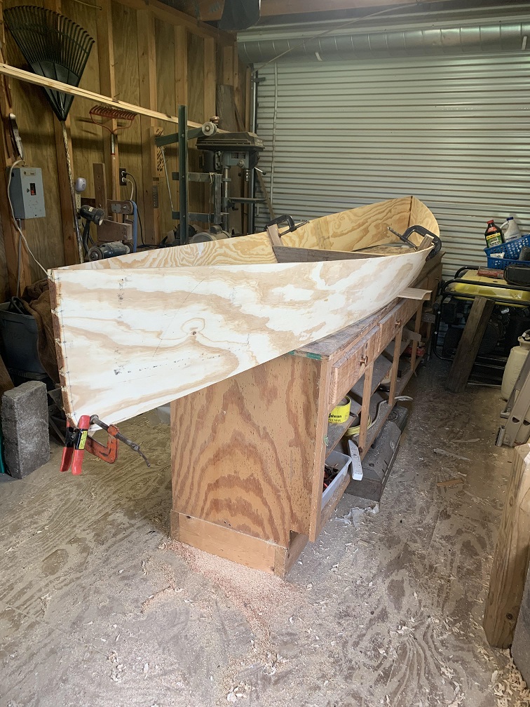

I put the boat up on the center form and epoxied up the stems between the wires. Now that I'm into it, I don't think I gained very much in speed or ease of build doing the hybrid build. Oh well, it was an itch I had to scratch.
I took the whole contraption out on a flat section of driveway to check for rocker. Looks like an inch or less. Perfect.

Chines are on. I plane the chines down flat and probably the bottom goes on tomorrow.
Next pirogue I'll do away with the fiberglass patches for the sides and bottom joints and just go with plywood patches glued with Titebond. I forgot about the waiting and the cleanup and the sanding when glass and epoxy is introduced into the mix. Bee, I might even go with wood stems!! Back to basics.
