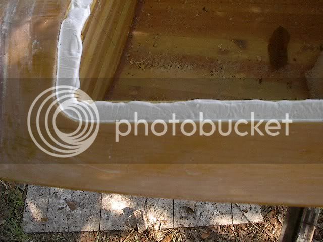

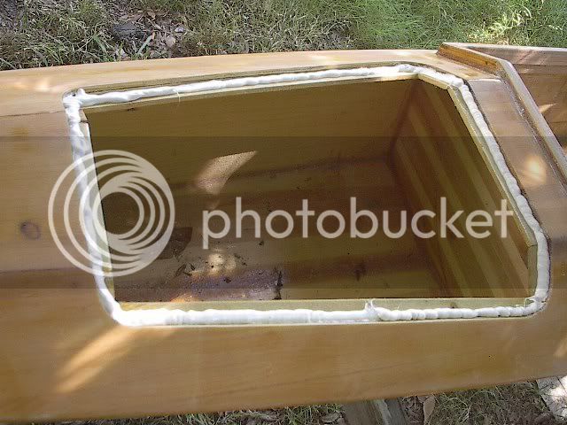

I decided to try laying a gasket and see how it works.

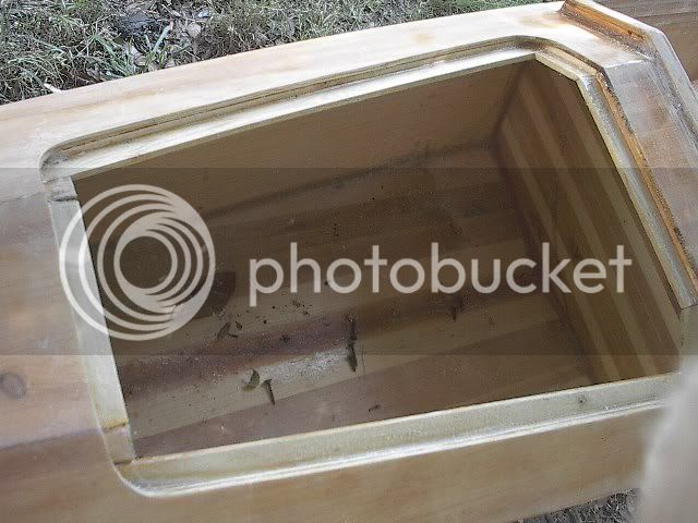

I sanded the lips just to rough them up
Then took a tube of silicon and laid down a heavy bead

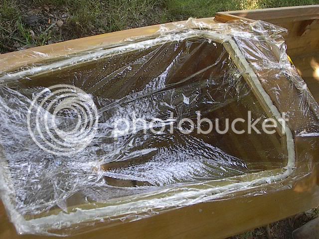

Then I covered it with saran wrap
then eased the hatch cover into place and put presure on it till it was the right level

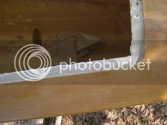

They turned out pretty good for the first try

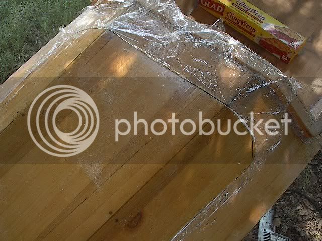

On the next one I will wrap the plastic on the hatch cover,should make it a lot easier.
I need to trim these up but am going to let them sit overnight.
Ronnie, it looks like the plastic wrap had wrinkles in it, and they each created a channel. Some of the channels go full width across the silicone implant. I suggest very carefully stretching the wrap next time, and applying a thin of silicone silastic over the original one. That should provide an even seal all around.

This was a little experiment ,and after I tried one Darrel reminded me of something I didnt do.I should have laid a heavy bead of caulk and the let it sit for 15 or 20 minutes and it would skim over then put the hatch cover on and tape it for 24 hours .
I will try that next time.
I think the hatch cover will compress it enough to take care of the wrinkles ,but on the next one the plastic will be on the hatch cover instead of the boat.
