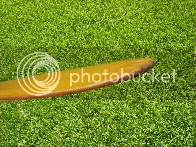

The edge of the rounded tip paddles I have built look like this:
Should they have a "sharper" edge? Like the top paddle appears to be. Kind of a knife edge?
Any advantages or disadvantages? Which way looks the best? :roll: I know the second one looks better than mine, but I'm asking about shape, form, and function.
Any thoughts on grip size and shape?

The sharper all edges are, the less resistance they have entering the water. Probably good for .000127 mph increase in speed. You'll get to your paddling destination 8 feet in front of your fellow paddlers. :roll: :lol:
When I used a single paddle, I made the edges just as thin as I dared to still maintain durability. I noticed it cut down on the turbulence when the paddle entered the water. Better to strike a balance between thinness and thick enough to stand up to all the other stuff a paddle is asked to do.

With work you could get a thinner edge and more durability. If you cut a narrow kerf along that end edge, then used thickened epoxy to build up along that edge, rooting it into the saw cut, then filed the set up epoxy to a thinness that suits you, it would be both thinner and stronger. But, only if you think it is worth that effort.

My paddles are balanced more to the "other stuff" because that is their primary function for me. I thin them to about the same thickness as store bought ones. I was mainly wondering about the rounded end. I guess I will have to make one with a "thinned" tip and see how it works.

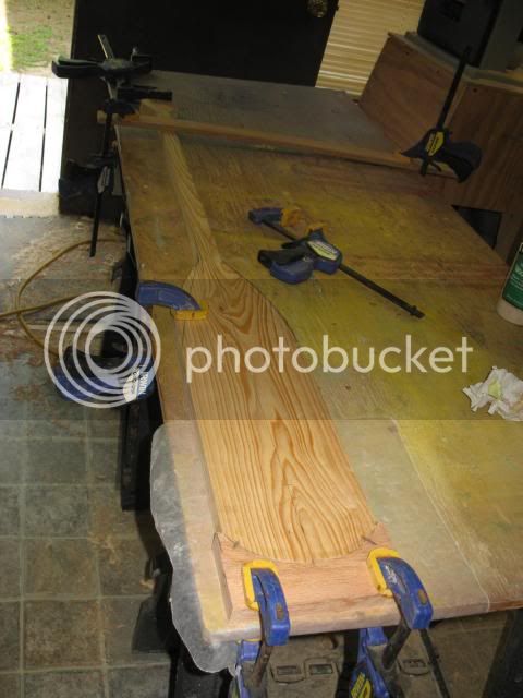

I'm trying to stay on my "epoxy diet". The soild wood and thicker edges along the tip are much stronger than the lamanated strips used in bought paddles. It does work well as a scarfice for the wood and looks good as an accent, but he epoxy would be out of place for a traditional solid paddle. I should say the paddles I have built have solid wood blades. The shafts have strip laminated to the face for add thickness, because I didn't have thick enough stock. The shafts are not round. They are oval or elliptical for a better grip and added strength.

Grampa JD, sorry, didn't mean to trump right into traditional territory. Maybe, just drill a few, small holes (0.020" in) into the end, and soak it in a bit of epoxy? That would,t show under paint, would add toughness, and could thus be a bit thinner.

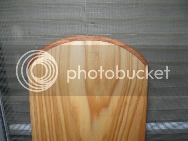

On a painted paddle the epoxy could be used and not infringe on tradition. I was thinking of the red tip I have seen on store bought paddles. The paddle I use needs protection. It spends more time stuck in the mud, and pushing on trees or concrete boat ramps than it does paddling. I have a paddle in the works that will address the problem in a "non epoxy" way:
It will have a white oak edge on the tip like the epoxy one you suggested.

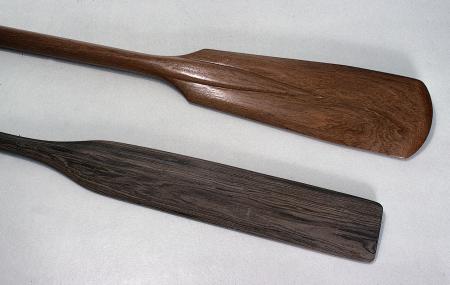

In the first post, the picture showing the blades of two paddles, do you happen to know the width of the bottom paddle, the darker one of the two? I'm wondering how wide the piece was it was made from.
And any hints about how the top end is carved, like the one shown in Joey's pic of the cypress paddle. Never made anything like it, myself. But I'd certainly like to.
One I'd like to make would be like the dark paddle with the square tip, as it looks to me like it would fit right in with a more traditional (OK, old-school) pirogue.

I have no clue how to describe a tradtional pirogue paddle. Not sure there is one. Don't recall seeing many shaped like beaver or otter tails, or with bent(on purpose) shafts. I suppose most makers used whatever wood was on hand. The paddle was what the wood would give them. Pick one style you like and call it traditional until someone proves you wrong. I'm guessing the square end paddle is about 4" wide and the other one about 6". Pretty common size lumber.
What style single paddle do you like.
got to agree with beekeeper,
old paddles around here are straight sided, squared off and no more than 6" wide. They're quick and easy to make and functional for what was typical everyday life. Remember the average Cajun was no more than about 5' 6" and 120 lb and paddling was not the primary objective of the day. He still had to work all day once he got where he was going, then paddle back home. He's not going to use a wide bladed paddle so he can go 7 mph and be worn out before the day gets started

I think beekeeper has it right. There doesn't seem to be any traditional pirogue paddle, probably because almost no one paddled pirogues for pleasure. It was a small, manuverable work truck. Someone made you a pirogue and you were left to make a paddle for yourself. Probably made with easily gotten 2 x ? lumber by a novice paddle builder.
I've seen quite a few old paddles shaped like the dark one in the bottom of the picture above. It does tend to favor the shape of the oars made around here...... squared off bottom with fairly long blade. My hunch is the squared off bottom gave a better purchase on shallow, muddy bottoms. The ones I've seen are pretty stout and made for heavy uses other than paddling........knocking tree branches out of your way in the swamp, prying your way through mud, and dispatching the odd snake.

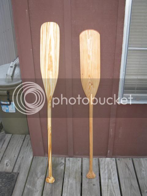

Finished the cypress paddle with white oak tip and a "plain old pine" one. The cypress is nice to work with using hand tools. I used pine for the other paddle because it is what I had and I wanted to make a paddle.
