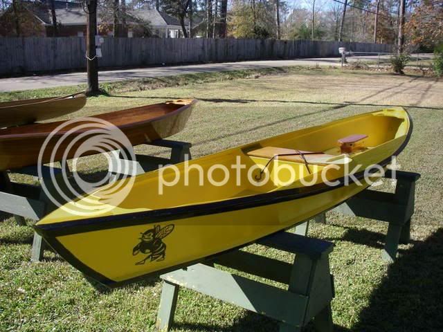

Seedtick has a very interesting kneeling seat maybe we can find picture of it. Heres the only one I can find for now.
You can just see the top of the seat in the Yellow pirogue.

I thought of buying one of those plastic jon boat type seat from Cheap-Mart. But your seat seems a better match. Is it hard to build? I guess if I'm building a pirogue then a seat shouldn't be too bad.
Years ago, my wife and I were looking for a dining room suite. (That's table and chairs.) I sat on and tested a LOT of chairs. See, I have this funny idea that a chair should be comfortable to sit in, for an extended period of time.
What I found was that a hard wooden chair - with a properly shaped seat - was more comfortable than a chair with a flat board for a seat and a pad on that flat board.
It all comes down to psi - Pounds per square Inch of pressure. If your derriere is sitting on a small area, there is a lot more pressure in that area than if you are sitting on a larger area. More cunning than that, though, is how well that contact area fits your individual hiney. Any pressure points will soon make themselves known to you. Mark them and hollow out that part of the seat. Test again, make spots and hollow them out some more. Repeat until you find no more pressure points.
On Chuck's boat seat, it looks like it extends out to support the bottoms of your thighs too. Hollow out to fit the bottom of our thighs and it will be even more comfortable. Then it will fit YOU. Not someone else - YOU.

Chucks seat is real easy to build, a good looker too. Good simple design, and a very functional seat.
