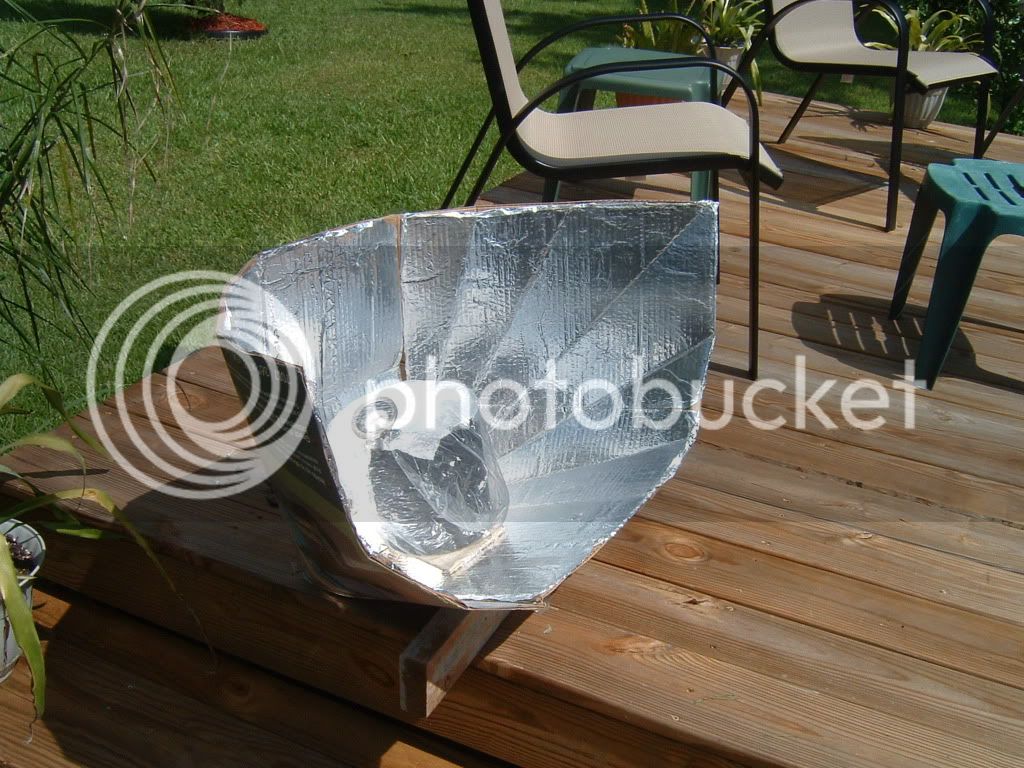

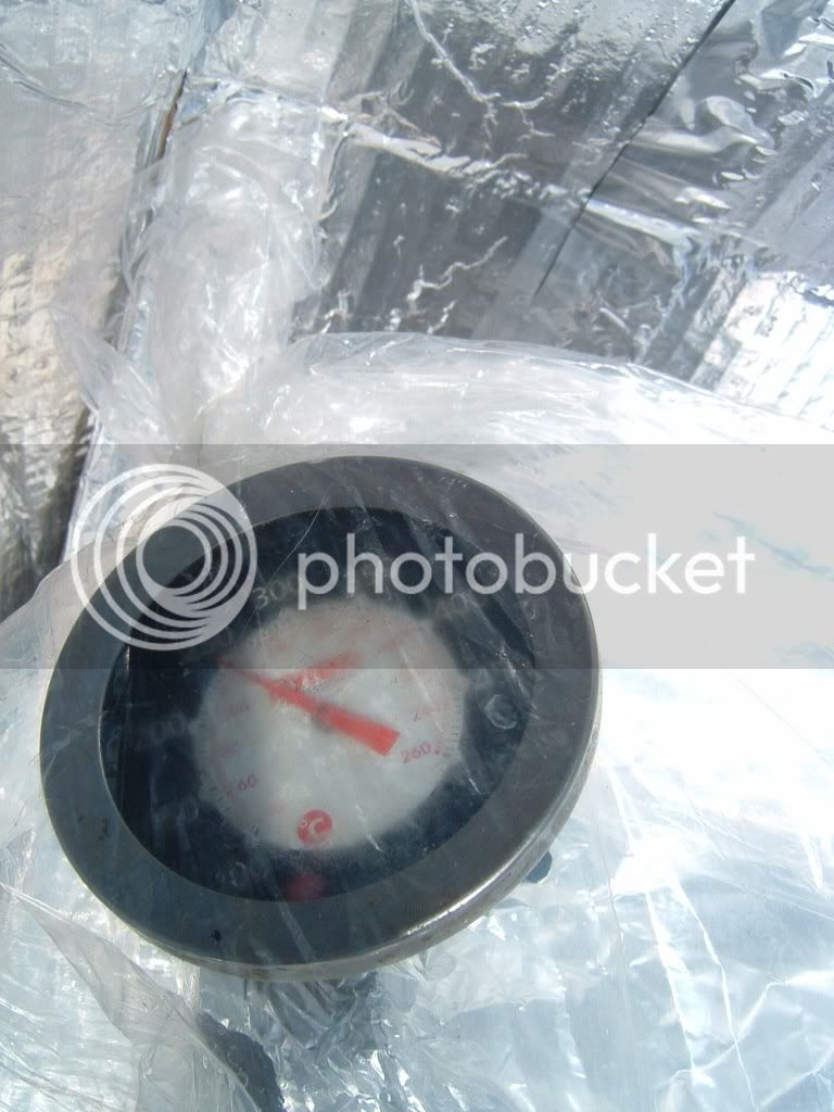

I finally got a chance to make a real simple solar reflector, just a 20-inch cube cardboard box and some aluminum foil. I used some grill paint to coat a coffee can and foiled the top and put my candy thermometer in it. It ran up to 250 Degrees in less than five minutes with two frozen Pilsbury Grands Flakey Biscuits in it. Just about that time my wife wanted to go shopping so I cranked the unit around to face the sun and off we went. We came back in a couple hours and the biscuits were cooked, and BROWN through to the centers. I wish i had a recording thermometer so I'd know just how hot it got in there. I'm convinced now that on a sunny southern day we could bake a meat loaf or soda bread or whatever.
I may be watching for a bigger box and figure out how to get the foil on smoother. If there was some mylar covered foam board that would really be the best answer.

How about some of the foilfaced insulation board used in housing construction? Smooth, lite weight, halfway rigid--it might work.
lil'moe, that would work great. Just need to find some large chunks of scrap.....part of building projects is getting the materials for free or nearly so. Also, this design depends on many narrow folds and i'm not sure that an insulating material about an inch thick could fit the bill. That's why i was leaning toward foam board, as it is about the same thickness as corrugated board.
I used a simple cooked flour paste to stick the foil down and that may have caused some of the hill and valleys. I might go looking for some spray on solvent based adhesive.
250 degrees ?! Heck, way overcooked meat has an internal temp of less than 200 degrees. Water boils at 212 so there's a world of possibilites there. Other than a longer cooking time, I'd say it's an efficient cooking system -no real "fuel" used. Might be used as a slow cooker for stews or cooking tough cuts of meat while the campfire or kitchen stove is used for other things.
