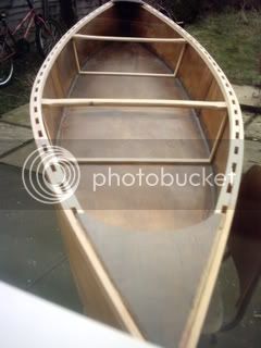

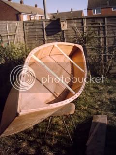

my boat looked a bit pink too :shock:
I used a walnut wb stain (dont know what brand,I cadged it off a painter on a site I was working on :oops: )
heres a couple of piccies that might give you an idea
before
after
hope this helps
cheers zeb

I used a walnut varnish as I only taped the seems on my build,I think it will probly chip and scratch easy and wouldnt recomend that route but it sort of worked for me to hide my mankey filleting :oops:

Hi CB I was looking at varnishes today and in the UK Ronseal do some exterior ones in 'clear' or a range of colours. They claim to have good UV filters and be better than conventional yacht varnish. Zeb's boat looks good in walnut.
