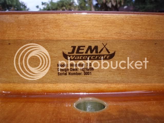

Here is a sample of stuff I have done. The JEM logo and serial number thing were scanned into the computer and then printed out on the medium. The fish was airbrushed on.
The medium is Heavy Silky Paper, same stuff used for artwork on surfboards. Laminated between the wood & the fiberglass cloth. Some others have used rice paper, sewing pattern paper, stuff like that.

I have not used rice paper yet, the Heavy Silky Paper is like a synthetic rice paper, I put it between the wood and the cloth, but just putting a coat or two of epoxy over it would work. Tho, you would have to be careful if you do any sanding (for varnishing or for re-varnishing later) over top of it that you dont scruff it up and then it might look fuzzy or sanded thru.
This is what it looked like before I epoxied it in, the HSP disappears once it get wet just like the cloth.
I have left over bits of the HSP, I can print some more of the JEM logo and snail mail them to ya. PM me your mail address if you want them.
Play around with rice paper or onion skin paper on some scrap wood to see if it disappears when wetted out. Also to make sure the stuff printed on it doesn't run and bleed once it gets wet
