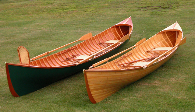

John gave me permission to use his book as a guide to design a S&G version of a guideboat. His book is based on the guideboat, built by Dwight Grant of Booneville, NY starting in 1905. This model was later named the "Virginia".

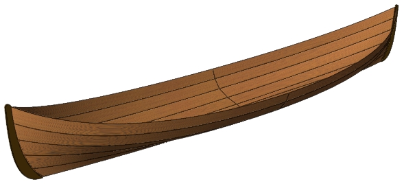

I'm about midway through drawing the guideboat on my computer and will use it to create a stitch and glue version. Guidboats are a very rounded hull. To duplicate the look and performance, multi chines will be needed.
For you potential builders who might want want to take on this project, how many hull panels would you like to see? I sketched an 8-panel (4 per side) version that looks respectable, but 10 would really do the job well.
Opinions?

To me it looks like it would be better being a 5 or 6 panel boat to maintain the conformity of the hull. The additional panels would let it be rounded out more with less sharp edges or angles to the hull.

I was thinking that as well but I don't want to make this build too complex. I think many guideboat lovers don't have one because the cost of buying one is usually around $4,000 and making one the traditional way requires a lot of equipment, skill, and space most folks don't have.
So I'm trying to strike that balance between performance and build complexity.

I'd say as many panels as is needed. I know. smart azzed response. :) But really, other than lofting, cutting and stitching. I don't think its much harder to do 10 than it is to do 4, or 6 panels.If one can do it for 4,one can do it for 10 eh?
Yes,
At least 10 panels. I think it is worth keeping as close to the original as is reasoable. One or two extra panels per side are not really that much.
There are no shortage of canoes out there with very few panels. I am guessing you want this one to be something kinda special?
Is the hull symmetrical? - One panel splice or two?
Traditional Guideboats are symmetrical.
Grant's Guideboat was 16' long. I'll probably try to stay as close to that as possible without needing more than one splice per panel.
There will be some ribs but probably only enough to accommodate the center seat and so it does not require a thwart. 2-4 "ribs" at most.
It will have stems that be made by laminating layers of plywood or thin lumber. Haven't decided the best way to handle that yet.

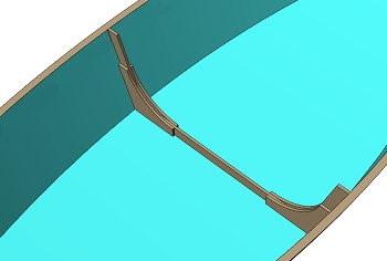

What I have in mind for ribs are more like frames. They will be about 2.5 inches "tall" and made of 3-4 layers of laminated plywood. Two of these ribs will be in the middle of the boat about 48" apart and probably 2 more near the ends.
It will be similar in configuration like my P-Row design:
The gunnels will also be stout.
Also, because this will be a multi panel hull, the panel seams will act as ribs longitudinal ribs. While I do want a rounded and pleasing shape, the very top panel will probably have just a bit more harder angle to create a stout beam and aid the gunnels with keeping the boat stiff.
