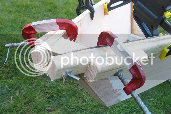

Hi,
I made a stem piece but not as complicated as the UJ design. You can see it in this pic.
I had just glued the outer rub rails on at this stage and had left them overhanging (I'll cut them back later).
The stems are just bluntly tapered (trapezoidal) blocks. When I'm ready I'll put a curved hardwood capping strip down them held on with epoxy.
