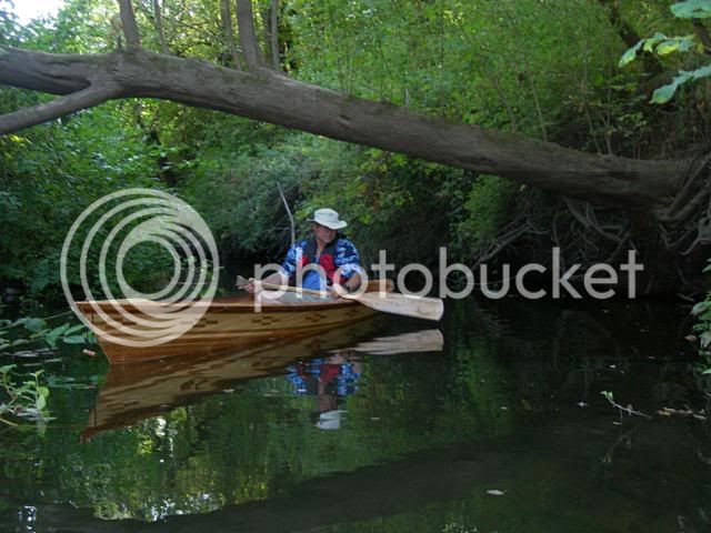

I think you will like the stripping ,It will probably be the only method I use from now on.
Thunder posted my duck build above and it is the stiffest strongest hull I have built.
