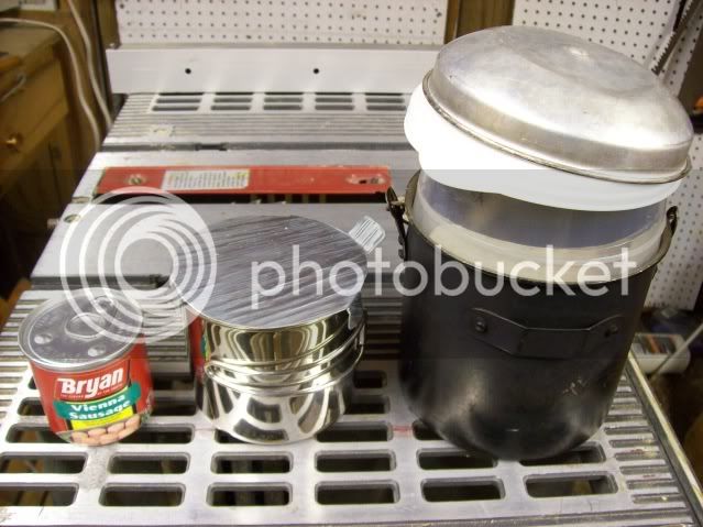

I've been experimenting with shrinking and lightening my camping and paddling gear. My regular cook kit is pretty darn compact and light already, but I enjoy trying to make it lighter and smaller. My latest kit is super compact. I can almost get it in the pocket of a pair of cargo pants. Check out the size in relation to my regular kit . The can of Vienna is just there for size comparison.........never eat the stuff. :lol:

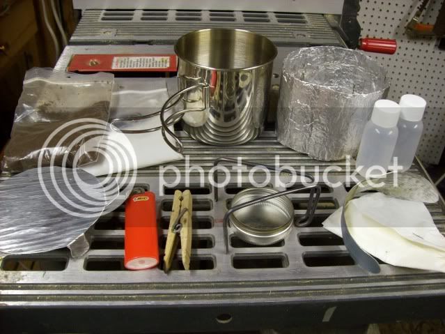

These are the contents spread out.
The stove (?) is the bottom of a tin of Gamo Match pellets. It can boil 2 cups of water with 2/3 oz of alcohol in about 6 minutes. One cup of water for cooking a bag meal and one cup for coffee. Clothes pin does double duty as lid handle and a coffee bag holder. The thing in the lower right hand corner on top of the coffee filters is a spoon I hammered out of a piece of aluminum siding just for kicks. To use, just bend it out straight. :roll:
This kit will do fine for day trips and probably the odd overnighter.

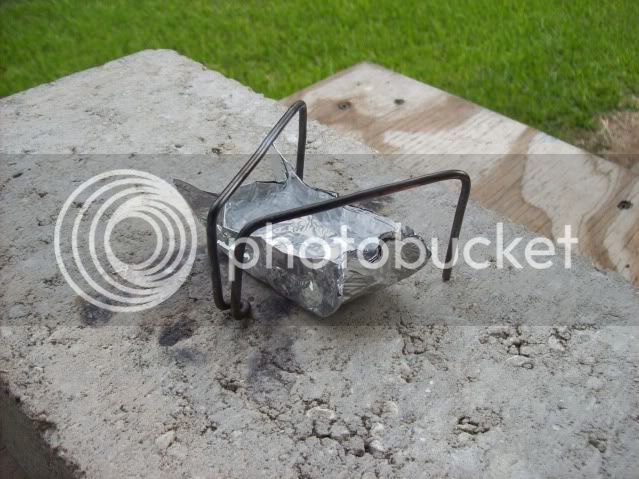

These little alcohol stoves continue to amaze me. I've made some slightly complex ones and some stupid simple ones. They all work and will boil 2 cups of water in from 5 to 8 minutes. I might have to test this, but I think you could fold up a small container from aluminum foil, fill it with alcohol, and it would work. Hmmmmmmmm. Be right back! :idea:
I'm back.........with data. Folded up aluminum foil into a container to hold about 1 oz of alcohol. 2 cups cold water. Time to boil .... 5 and 1/2 minutes. No discoloration or distortion of foil container.

What kind of wire did you use for the little wire stand to hold a pot? Coat hanger wouldn't hack it. #9 clothes wire?

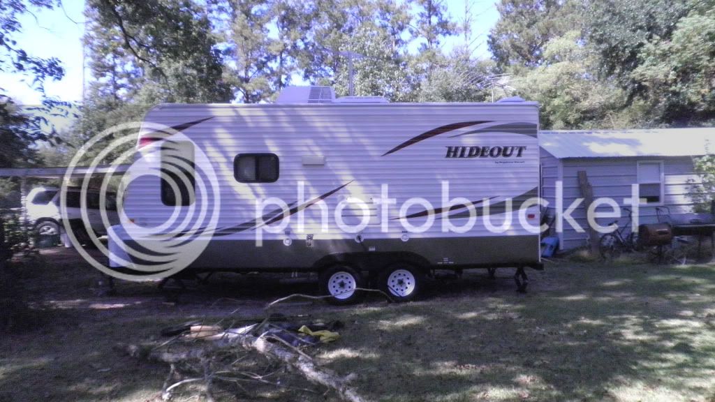

Joey, you always motivate me to go one more step. After seeing how you trimmed your cook kit I decided to do the same. Between the first of the month and last Friday I trimmed over 2000 pounds off my camping kitchen. The old one was 26 feet long and the new one is a mere 19 feet, and over 2000 pounds lighter. Thanks for the inspiration. Piper
