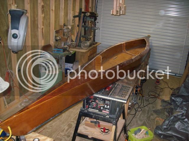

I love the old gal, but a kayak is not too handy in my neck of the woods. With no gravel beaches or sandbars to sidle up to, getting in and out of a kayak is a pain. It's not really comfortable to fish out of and you can't reach the items in the compartments while underway.
To that end, I taped up some nice flowing lines on the deck and cut it out leaving 3-4" tumblehomes and 3 foot decks. I cut out most of the bulkheads and left enough meat to act as ribs for strength. I need to smooth out some of the curves and then epoxy on some 1" x ? strips to form the cowling.
If I remember correctly, the hull with no deck weighed 27 lbs. She ought to come in easily at around 35 lbs. Cool.
![](/community/proxy.php?image=http%3A%2F%2Fi198.photobucket.com%2Falbums%2Faa106%2FBayouboy1954%2F100_1658_zpsbd232bbb.jpg&hash=92381088f30203bb67fbf923b4973ddd)
![](/community/proxy.php?image=http%3A%2F%2Fi198.photobucket.com%2Falbums%2Faa106%2FBayouboy1954%2F100_1659_zpsd3cf0cec.jpg&hash=b7a19e0b866a5cf42d27c1407e99f206)
