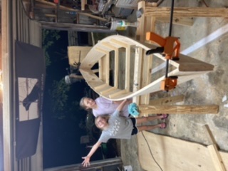

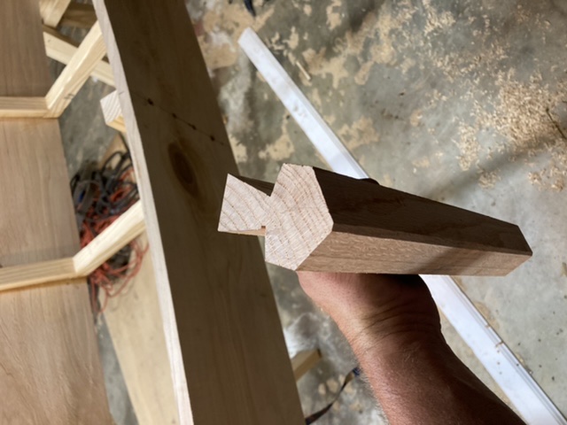

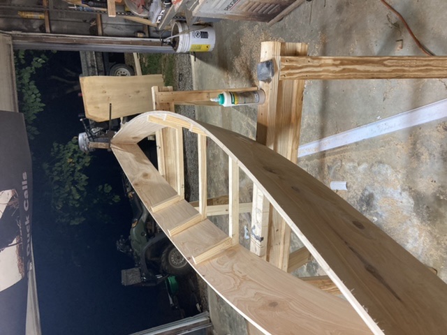

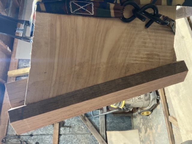

Hey guys just wanted to give y’all a little update on how it’s coming. Had a little help from a great guy. Made a friend in the process

I forgot you mentioned having cypress boards to use. The boat looks so robust compared to the plywood most boats are built from today. It has to be nice to work with real wood. The boat looks very nice and is coming along well. Looks like you have good help.
