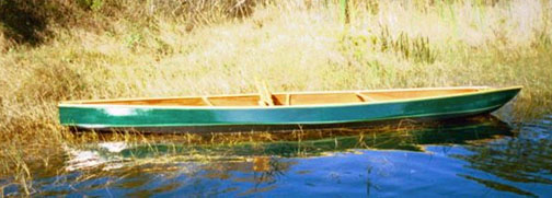

Chuck built a JEM Swampgirl with a transom. It's here somewhere as well as the JEM site. Not exactly a pirogue, but seems to fit the mission other than rigging a rudder on the smallish transom along with the trolling motor.

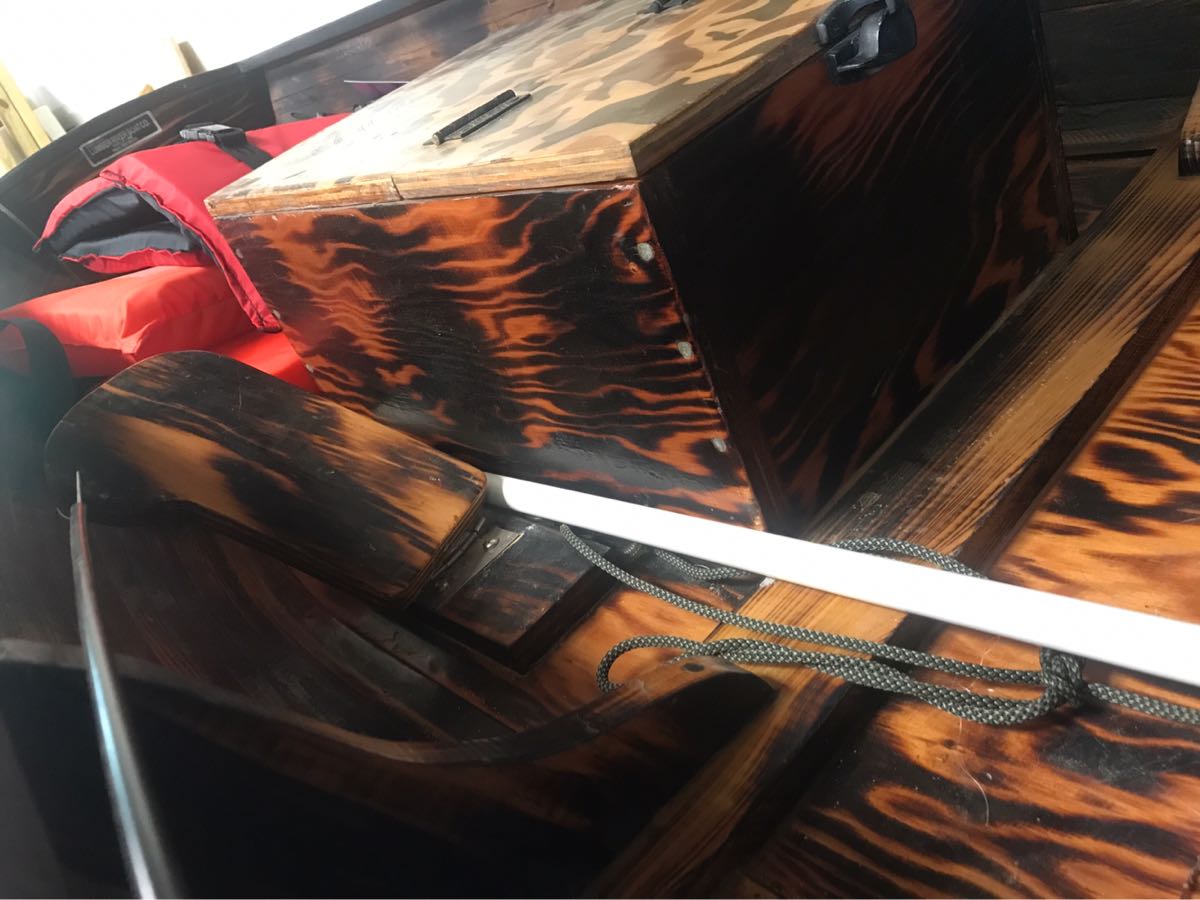

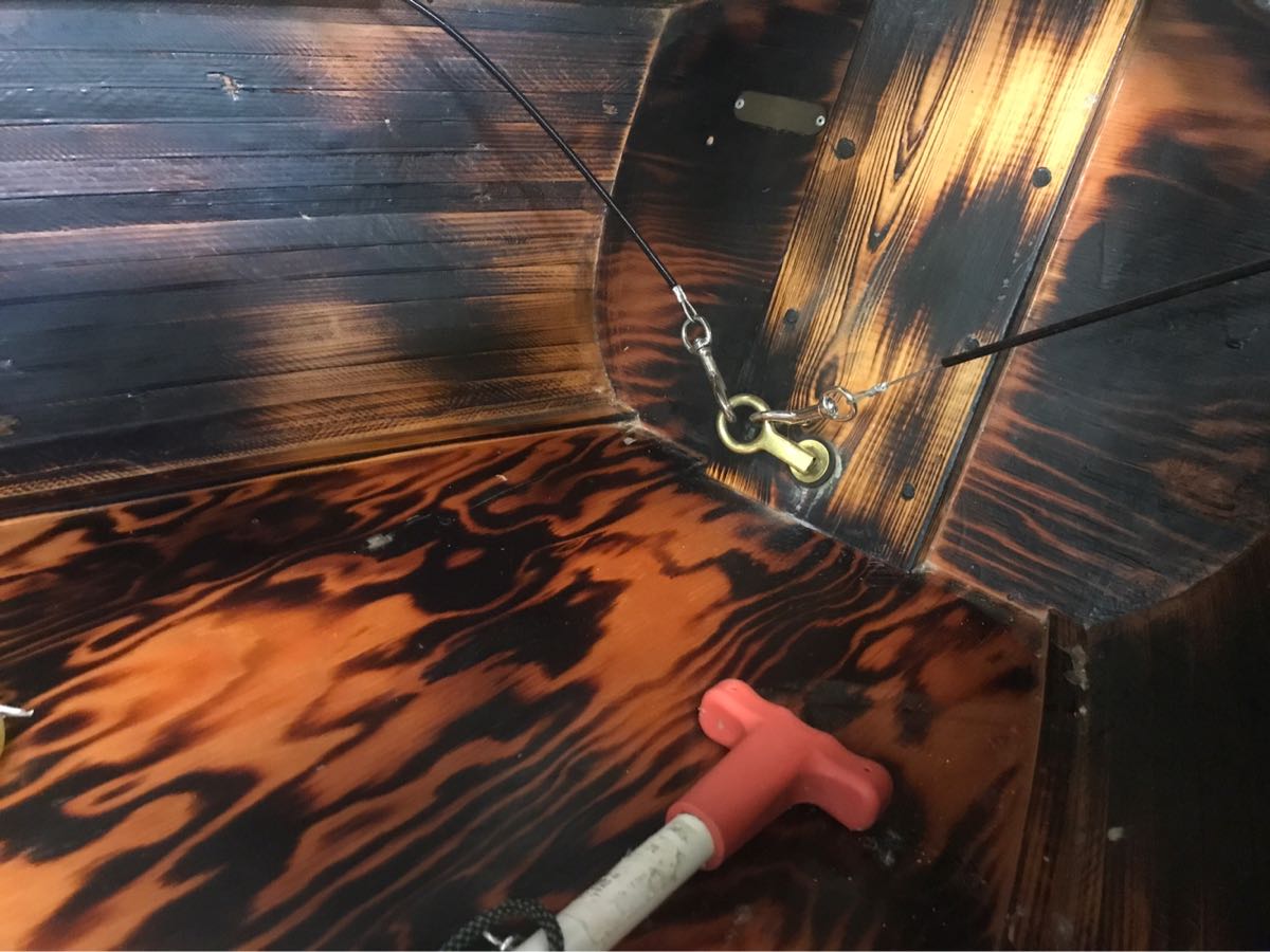

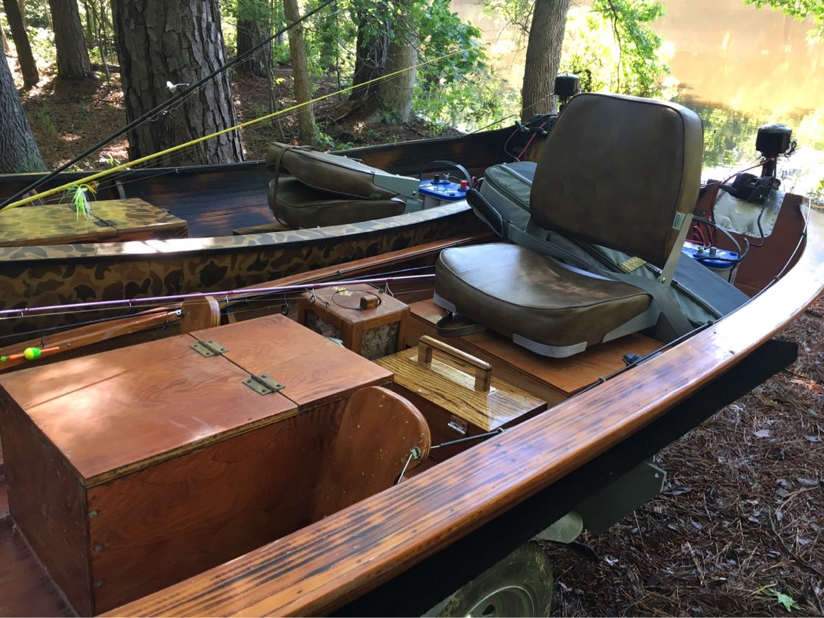

Hard to shrink pics for forum but no rudder pedals have cables through a tube that have clasp like a dog leash that hook to troll motor and turns motor
Speed and reverse controlled by reostat hooked by Velcro to side of boats

These are the boats pic 1 camo is 10 ft 8 inch
Short one is 10 ft
Pic 2 shows clasp I just hook them to drain plug when motor detached
Pic 3 shows pedals and cable hinges epoxy to floors as well as live well

Thanks for the pics, that makes sense now, and is simple in the good way. Somehow I was hung up on needing a rudder to go with rudder pedals. Both of your boats look perfectly suited for their job. Nice work on them.
