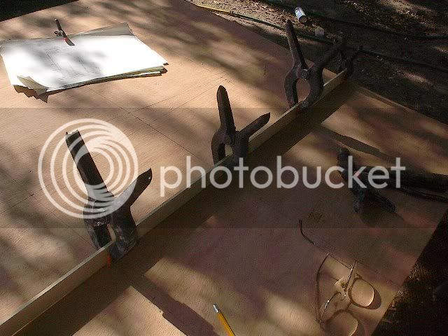

Got some time to work on the 15 5 today. I am going to show some pics of the layout just for the new guys.

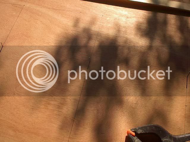

First layed out the twelve inch lines on the ply

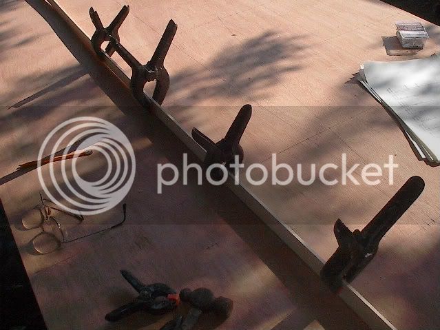

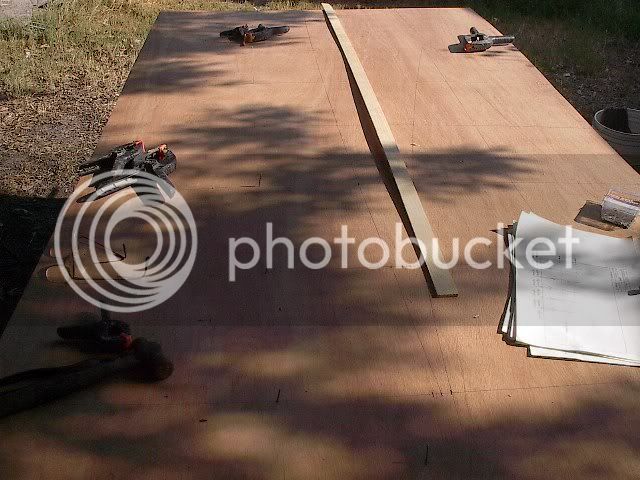

then measure of the points from Matts Plans I drove finishing nail in at the intersecting points and then used a piece of molding to follow the curve, clamping them to the nail
the last pic is after the lines are scribed on the ply

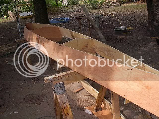

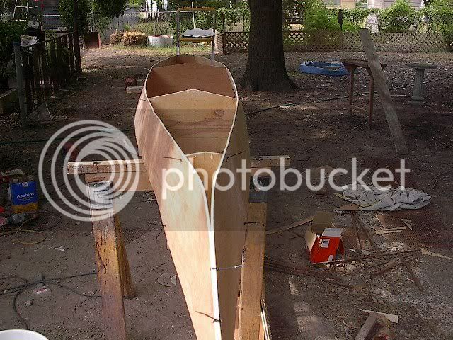

Moving right along got the stations stiched in
another angle

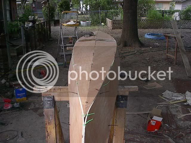

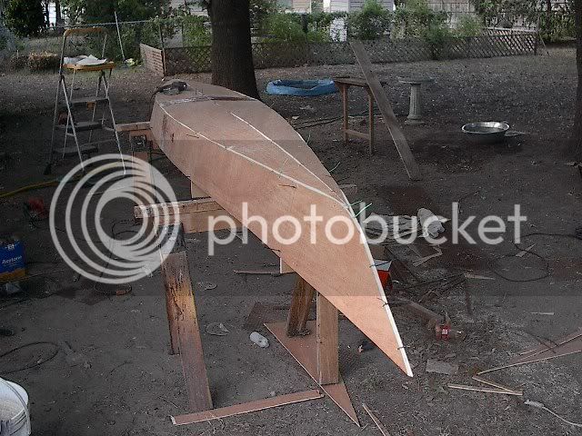

started stiching the bottom on
Man this thing is long and lean just looks speedy sitting there
