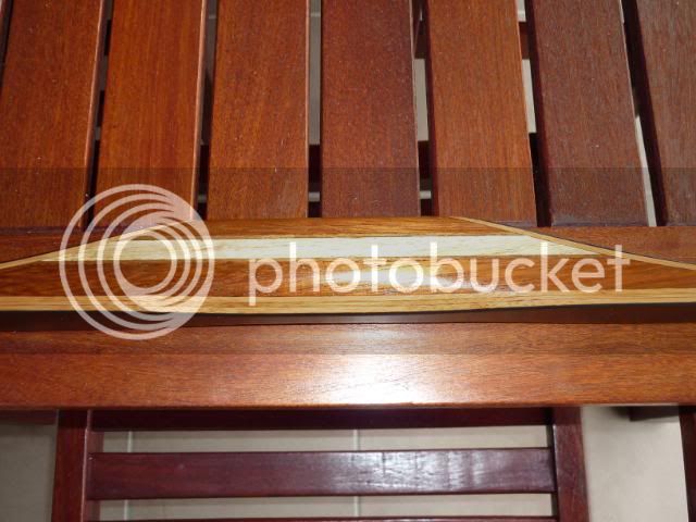

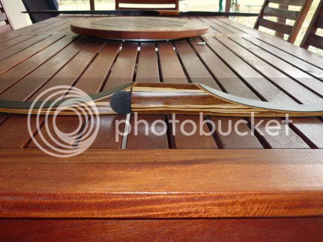

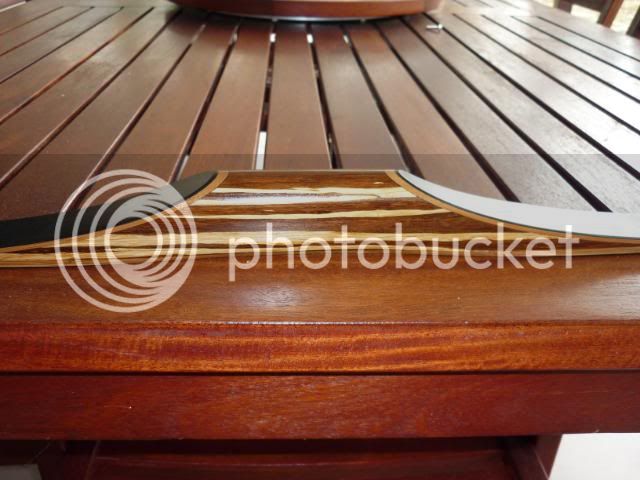

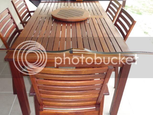

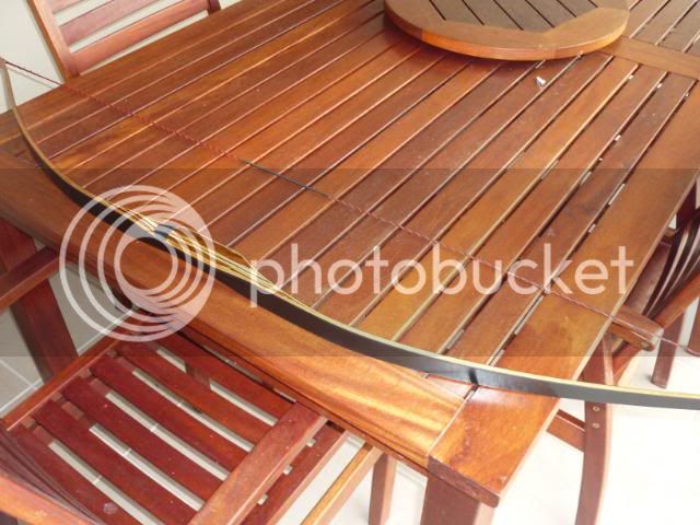

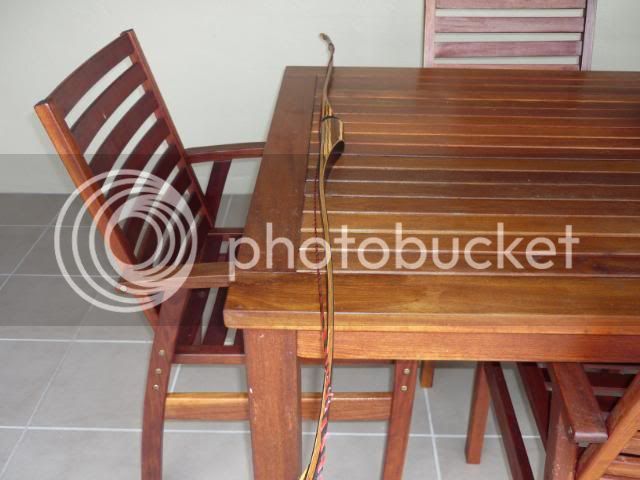

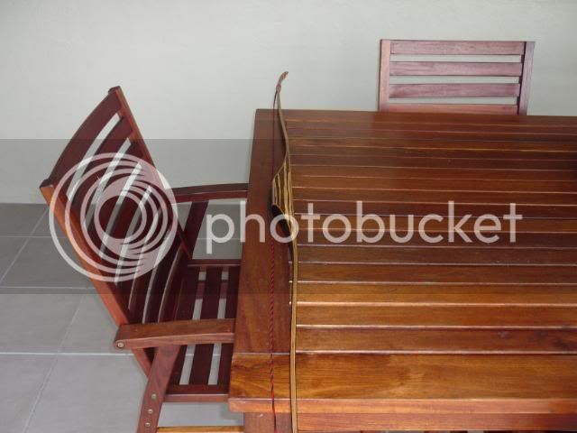

Well I usually forget to post pictures of the bows I make or even remember to take pictures of them but Chuck always reckons that more stories with pictures makes the site interesting and one of the bows is for Hairy Mick
So here goes , Micks Bow is 43# @28" and 68" nock to nock , 18" riser is Kwila with some sort of timber from around the Daintree rainforests in North Qld , never did know the name of it and Sallie Wattle , laminations are Coffee Bamboo flooring

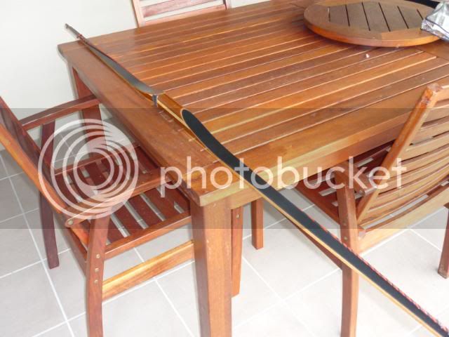

Next bow is for my wife and is 64" Nock to Nock and 32# at 28" , 16" riser is Zebrano Bamboo flooring and the laminations are Coffee Bamboo , I used my Binghams style Reflex / Deflex form

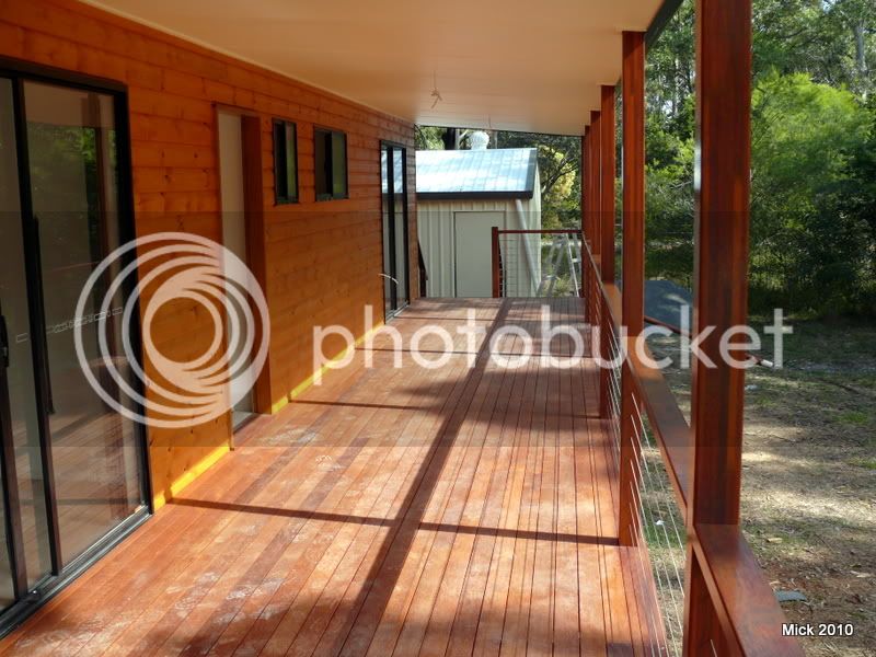

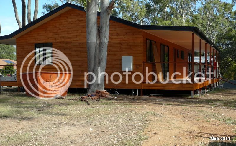

been building a beach house. 8)

No problem , now you got to tell us the story of the house , looks great , where is it ?

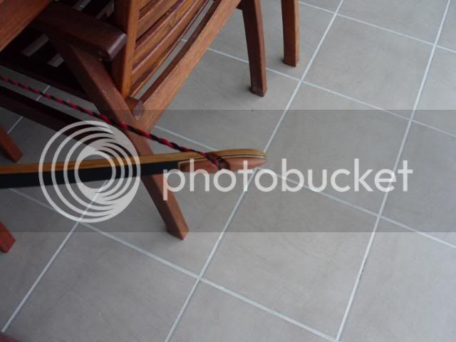

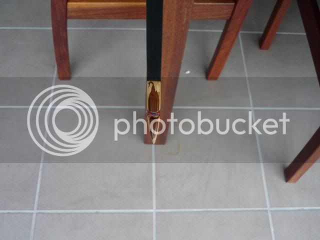

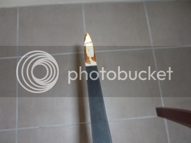

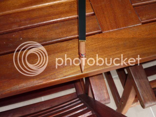

The Tips always cause me problems getting them just right and even with spending 4 hours on each of the tips on Mick's bow I still don't think them completely right but they are as good as can be and if I go any further I'll only go the other way , they seem to be a thing that actually gets harder with each bow as you want to make the next one better than the last , also my eye sight isn't as good as it once was and now I've taken to wearing the cheap magnification glasses to try and see better up close , even so I've found that the best way for me to see imperfections in the bow like sanding marks and such is to give a light coat of finish , let it dry and then look at it in the sun
Still on the tips , I much prefer the pointy style tips I do to the blunt styles , it's just personal preference but I think they do look better on a longbow
