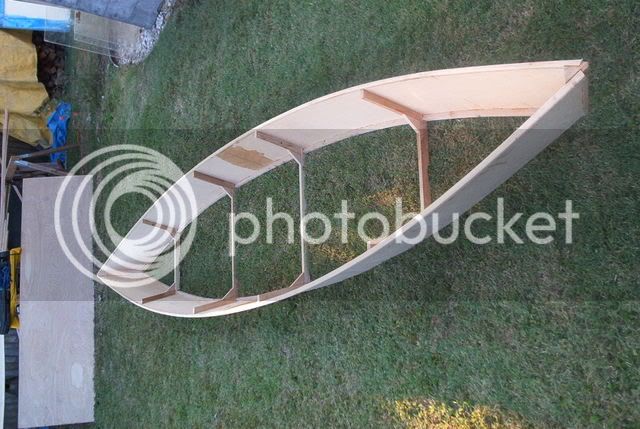

I have the ribs screwed in temporarily and the gunwale and inside chines glued in.

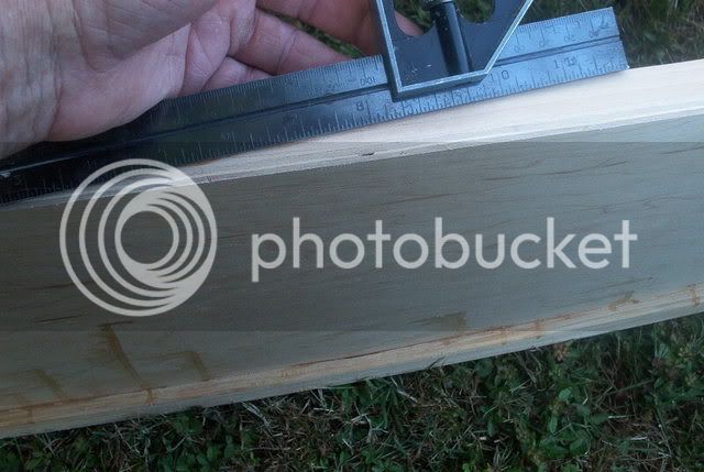

This is the first void that I have run into with this cheap plywood. (3/16" Luan from Lowe's) It's only 1/4" long and less than 1/8" deep. Not bad for the cheap stuff.

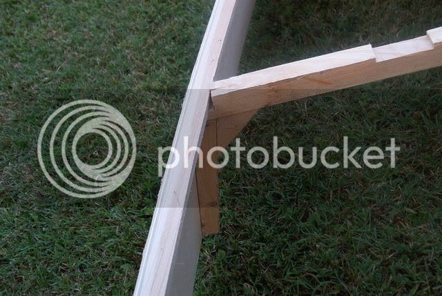

Here is the rookie mistake of the day: I had a temporary brain seizure and forgot to cut this rib notch on an angle. There are 8 notches in 4 ribs, so I can justify this and say "Oh well, 7 out of 8 ain't bad! The fortunate part is that the notch is on the bottom of the rib, and will be covered with glass and resin. So I am not too concerned about it. I wonder if I will think about this notch when i am in 50 feet of water and 1/2 mile from shore!

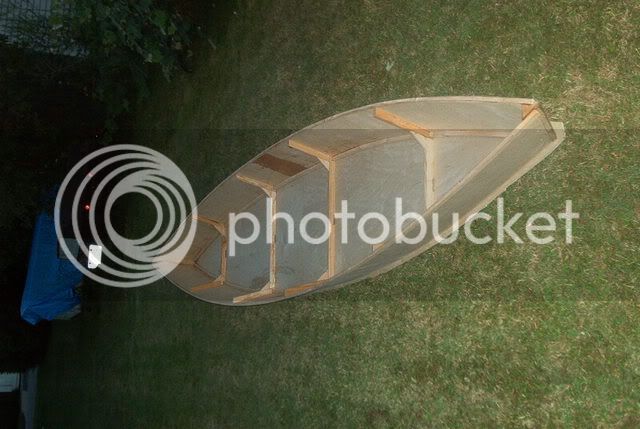

This is a shot showing the bottom screwed on temporarily with brass screws. At this point, my wife came out in the yard to tell me dinner was ready and her comment was "Oh it's a boat, I wondered what all this wood was for." They just don't understand ......it's not just wood, it's much more than that. This thing is beginning to develop it's own personna.

I had a frame that I "over-fitted" a little bit and there was a gap left in the process. At one point, not sure when, I spread a layer of epoxy around in the gap. Then I mixed up a rather thick putty of epoxy and wood flour and filled the gap with it.
Worked out pretty good.
Now then, if I found myself "in 50 feet of water and 1/2 mile from shore," I'd not be thinking about that little gap-thing, I'd be wondering just how the heck I got out there!
