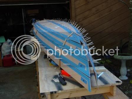

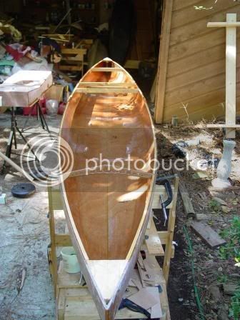

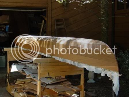

I have a table set-up similar to swamprat's, twp 8'x2' sections from one piece of plywood and then another section 4'x2'. Any can be attached end to end, so I can have a 4', 8', 12', 16' or 20' work table, depending on what I am working on. Needed the 20' for my CLC WR18 hull panels.
Here's my JEM watercraft Wadefish 2.0 on the table set up.
Made a roll around base that I usually have the saw horses I made attached to. Easy to roll in and out of the garage.
The saw horses have a removable top piece, so I can have a solid cross member when I need it.
Remove the solid piece and I have nylon straps for support when I need them.
I use the copper wire method. Tho, stitching the hull with wire is kinda rough on the finger tips. With the copper wire, it doesn't matter if it gets bonded in with epoxy, it sands down easy. On my first boat I left them all in, all other boats I removed all.
DM

Dangermouse, I like the idea of sections that can be joined and so are adaptable to different boats. Also, what's all the blue tape on your panels in the picture? Was this to stop tear-out when drilling the holes, or when cutting, or did you mark the dimensions on the tape?
The saw-horses with removable section are a great idea.
