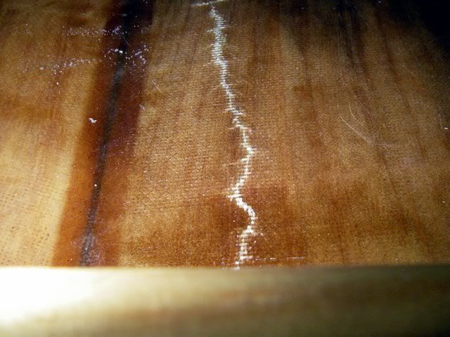

Long story short here, I bottomed out in one of the races on a sharp rock - hard and fractured part of the bottom panel of my boat.
This is in no way the boats fault. She is completely sheathed in epoxy and fibre-glass cloth inside and out and I think that any fibreglass or timber boat that hit the rock as hard as I did would have failed. Another boat, a commercially made fibre-glass canadian canoe suffered extensive damage in one little run.
I guess what I am looking for here is some advice or ideas on how she might best be repaired. The panel is only 1/8" interior grade ply and I am allmost certain that water has got into it at the fracture.
Any suggestions or ideas would be greatly appreciated. :D

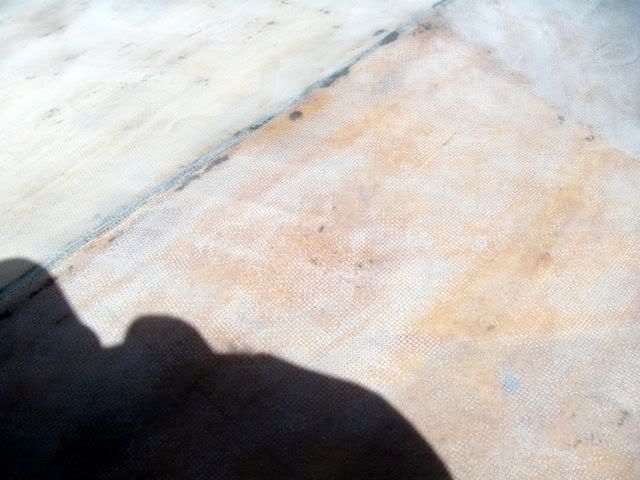

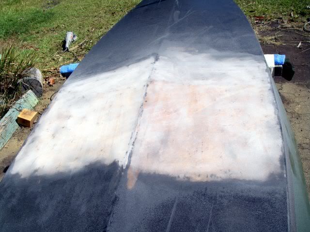

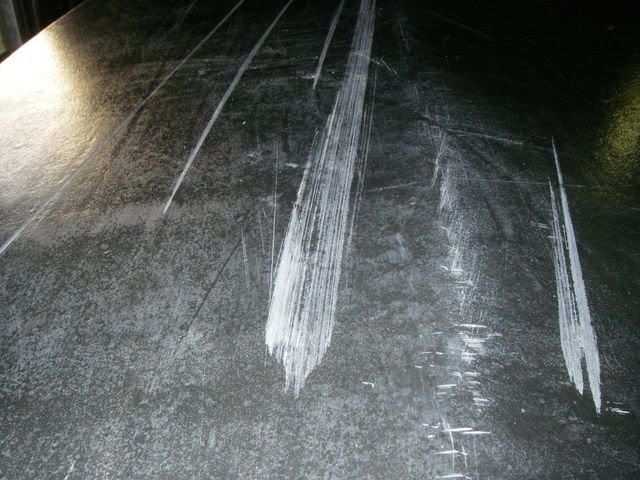

Bottom is sanded and scraped back to remofe the graphite.
Damage to the outside is minimal :D

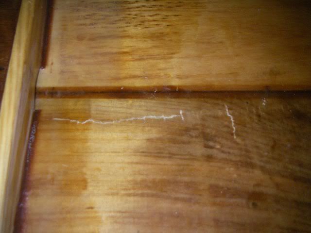

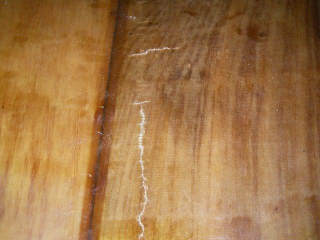

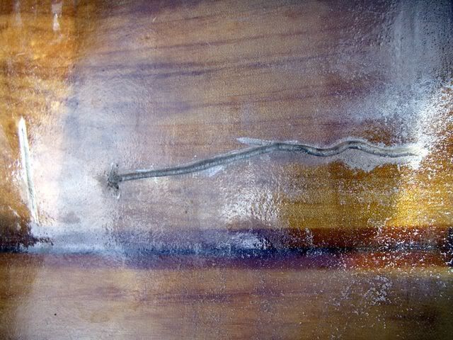

Inside is cleaned up and the cracks cleaned out with a dremmel. These little tools are priceless for this. Took about two minutes :D

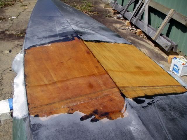

A patch of 8oz cloth is wetted out over the outside. (Waiting for it to set up a bit now) :D

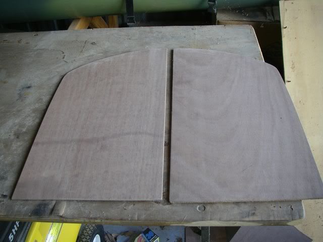

Also while waiting, I have marked out and cut two patches for the inside floor. The second patch is a matching one for the other side of the boat.

Can you give us a pic of inside the boat so we can get an ideal where the fracture was and desribe what kind damage was on the outside.

Sanding off the graphite is definately no fun :D

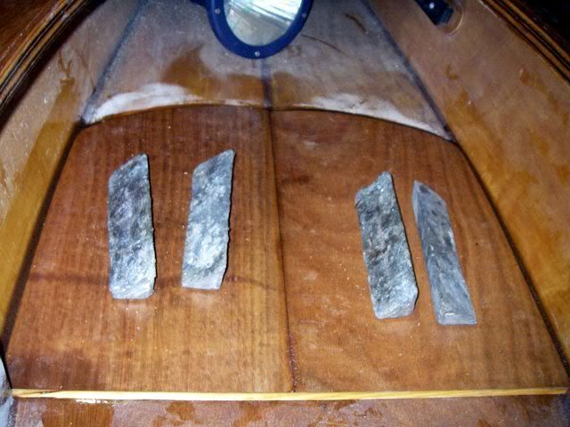

Bit more done this afternoon.
Backing plates are glued in. I decided not to add a fibreglass patch between them. I really don't think it will be necessary on this boat.
Plates held down while glue goes off.
Fillets done :D
This is turning out way easier than I expected. :D also got three filler coats on the bottom today.
