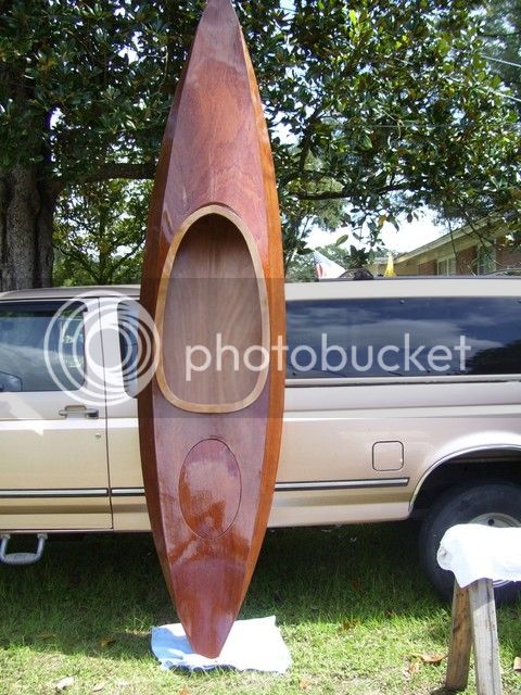

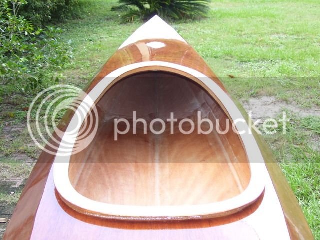

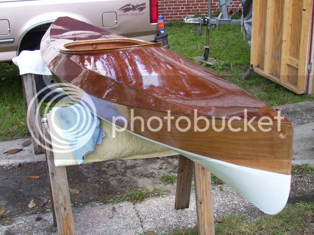

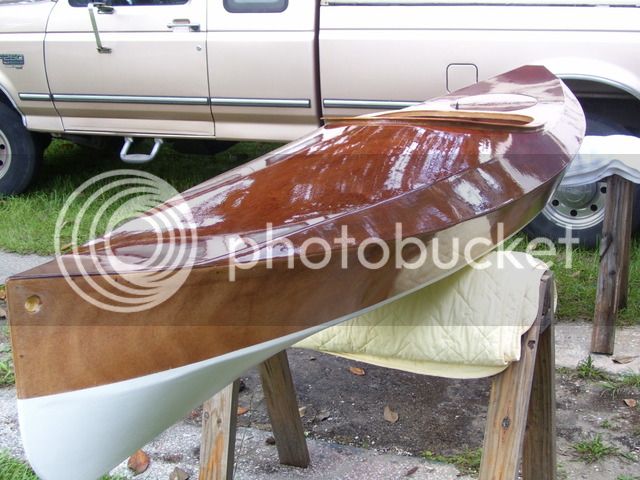

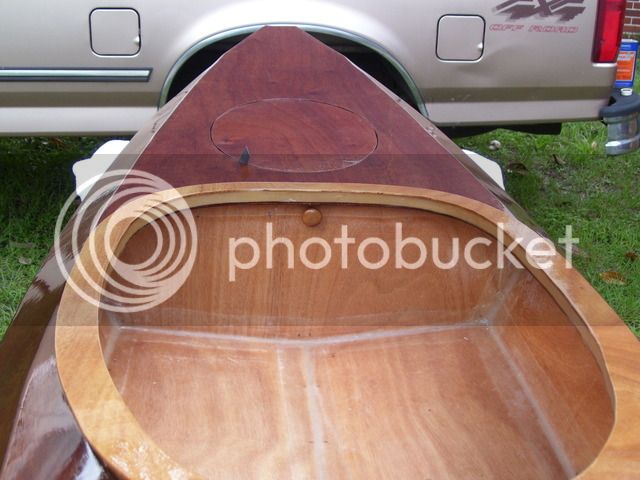

I have her done and the varnish FINALLY got hard enough to move her outside for some decent pictures. This is the first time I've used spar varnish by Rustoleum. It's pretty thick stuff and they say don't thin it. It will skin at a decent pace but don't be in a hurry for the cure. That's the only issue I had with it so I can't complain.
I had some epoxy clouding due to moisture during this build, broke down and bought a used dehumidifier on Craigslist. I'm here to tell y'all that's the ticket if you live in a moist climate. It warmed the shop up about 5°but kept the humidity down to 30-35°. I could do epoxy and varnish anytime! Also seems to make sanding easier.
I'm going to wait a bit longer before I lean her on her sides and climb in to mount the foot pegs, other than that she's ready for the splash!
I didn't even see the dust in that last picture till I looked at the photo!

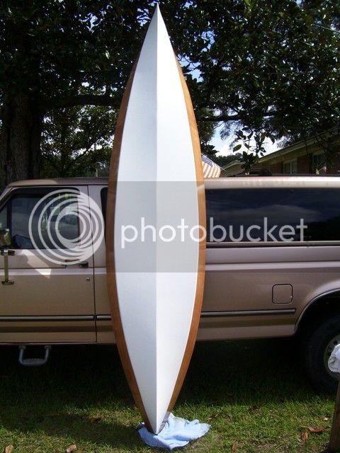

The white bottom may be useful for fishing? A fish will see bright sky instead of a shadow, and not shy away, maybe? (That may take a lot of research time too.)

Jack you're spot on about the white bottom. My hull is white and we put the graphite/epoxy mix on Robins, Figured we would compare how they wear over time. we paddle together all the time and consistently fish spook closer to mine. Even the gator gars that scare you into regularity. We've also noticed that when the mullet are jumping I'm their preferred target. I'm sold on the white bottom. Hmm, song title? She wins the abrasion test though. Gotta give the graphite due credit - it is tough. But it get way too hot in the Florida sun to transport exposed.
