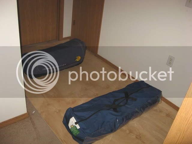

It has to be its storage
their are no water stains
Joey I brought them inside
campin gear for weight
Perhaps one side, the outside of the bow, absorbed more moisture than the other? If one side was against a wall, it can gather moisture in from an outside wall. Can also may get more heat and air on the room side and less on its wall side, doing the same effect.
Hey Oz.
Just got back from the gunshow and read about your plywood. Plywood or board, if it bows just throw it out on the grass with the crowned side up and watch it. When it flattens out get it out of the sun and store properly. Moisture is your problem.
