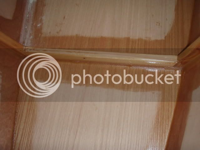

Mudd, the fillets go in before the glass to radius the sharp corners facilitating much easier glass application to said corners. That lawyer speak stuff is real nifty :lol:

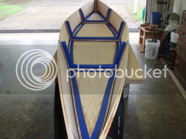

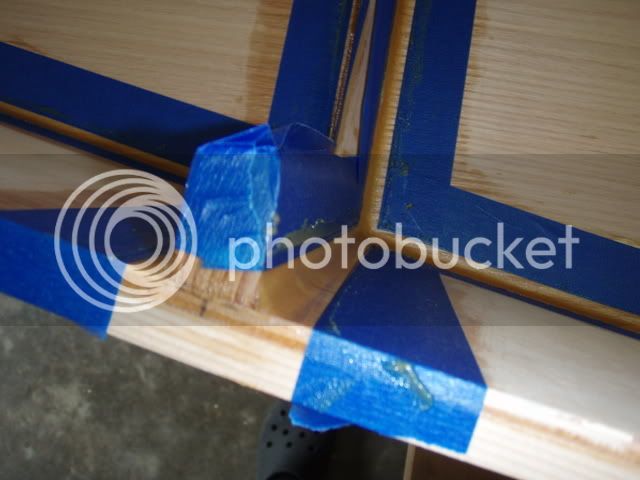

Anywho, after putting masking tape along all the joints about a 1/2" on either side mix up about 3 oz of epoxy (work in one section at a time) and add enough wood flour to make the epoxy like a paste or putty.You will know when it's right.
Then take a quart size zip lock plastic bag and turn the edges over a jar or container that will allow you to put he putty into the bag. cut a small corner out of the bag and spooge it out like it's cake icing into the taped corners. then take the tounge depresser and scrape along the joint with the rounded end of course at 90 degrees and your left with a nice neat rounded fillet. As you work you can scrape the excess putty into a plastic cup and reuse it in sections that are thin or need more material. Don't play with it to much and let it set up for a bit till it's tacky. then peel off the tape before it becomes part of the boat. Then you can glass after all is dry and lightly sanding the inside
It's all good Mudd. Here are some pics of the process.
