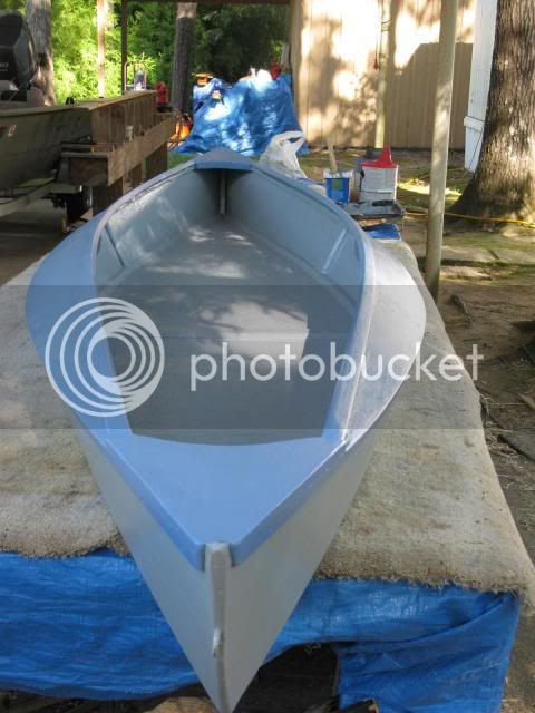

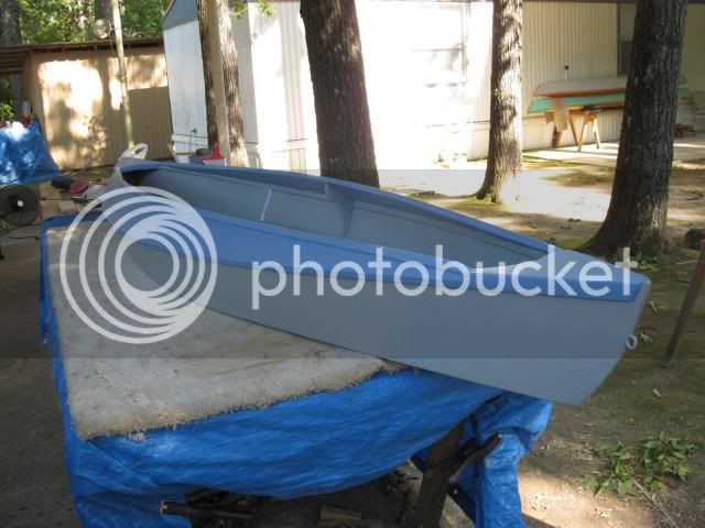

Finished this one recently. It is a takeoff from a style of fiberglass pirogue popular in this area. Same size as my friends fiberglassed one, only mine is wood and has a flat bottom . Not tunneled like the factory made one.
11.5" long, 28" max. floor width, 34" overall beam

Interesting lines on those tumbled home gunnels.
They are an experament and learning process to improve my "truck boat". For me a 34" beam at about 8" high is the max. beam I can paddle well. I like the benefits of flaired sides, but it is hard to manage both. The tumblehome works, but it will also give the boat a nontraditional pirogue look. I was trying to stay with breasthooks and not deck the boat.
