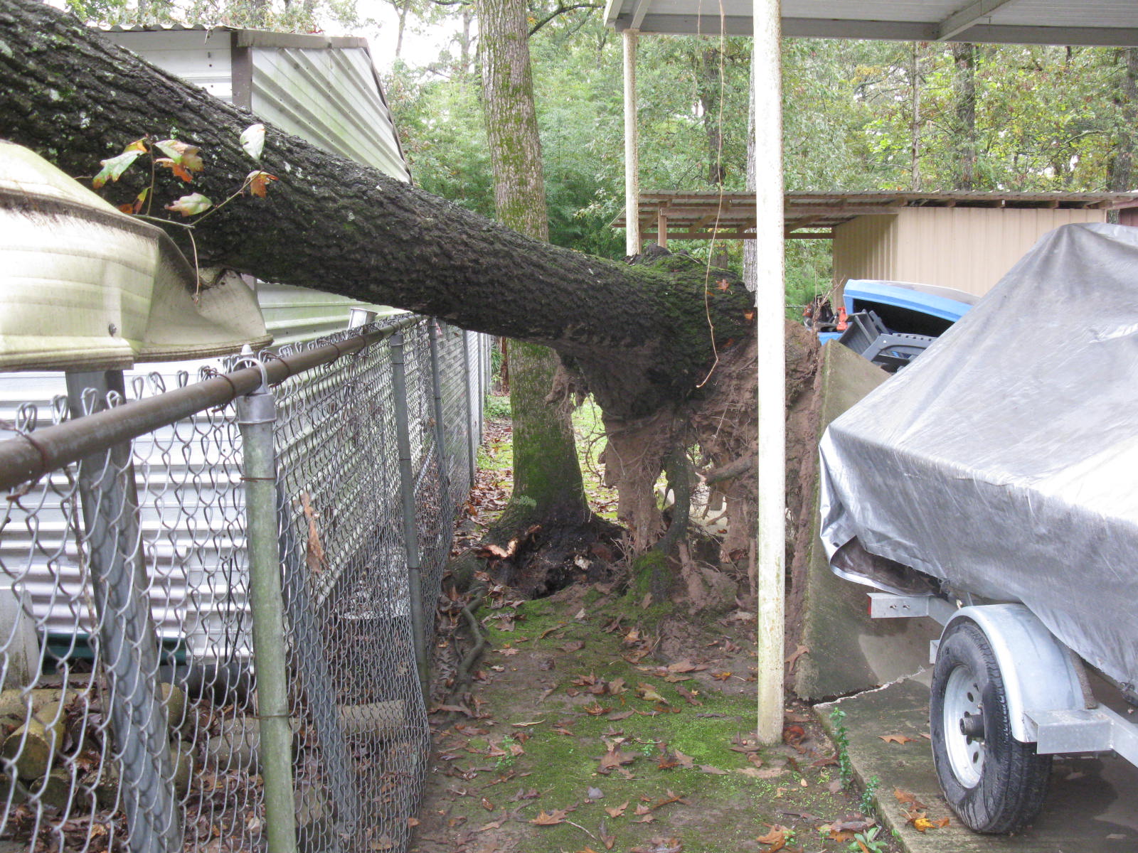

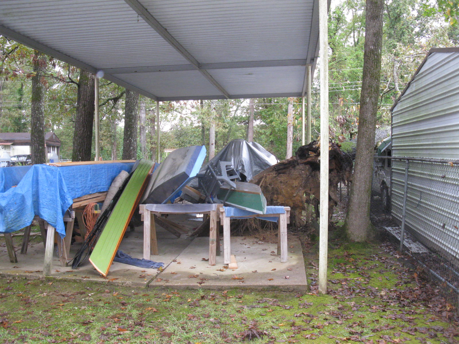

Some interruptions
are bad, like this one. Could have been much worse.
Tree uprooted and broke the concrete slab the boats were stored on. Neighbors fence, car and cover, fence and gate were damaged. Root system was rotten under the ground.

How dare the weather mess up your pretty boats. Glad it wasn't worse. The tornado in Dallas last month missed us, but was close enough for concern.
The summer when I was 4, a tornado came through our part of the country. Not a big one, but it uprooted a lot of trees. Their trunks laid flat on the ground with their rootball sticking straight up. The dark dirt still sticking to the roots looked to me like the mouth of a cave. In the woods, where the light was already muted, it was kinda scarey to a little twerp.
Looking back, maybe that's when I started thinking about single malt scotch?

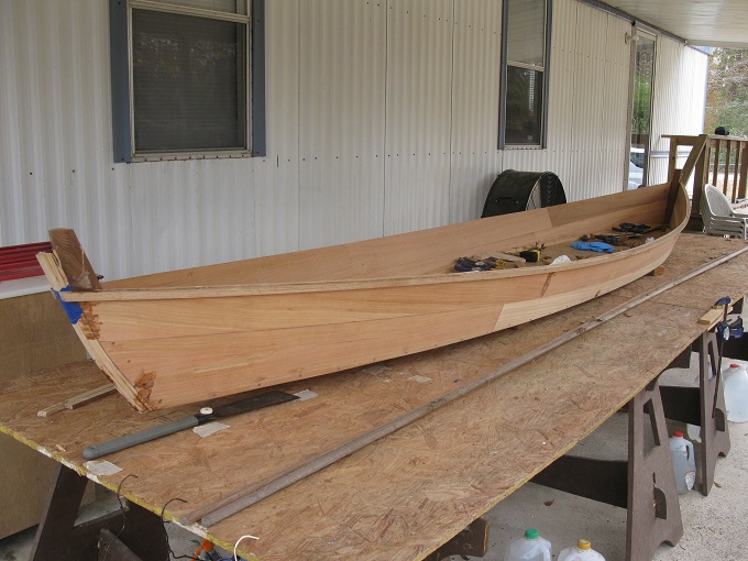

Made a little progress. Got the boat off the strongback and installed outside gunnel strip.

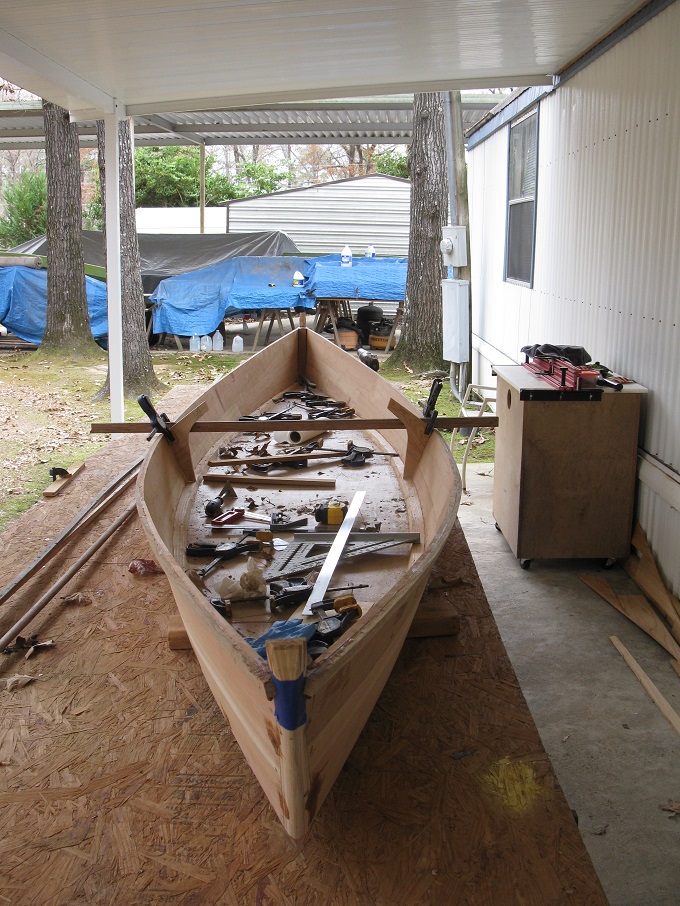

Installed the two center supports for the tumblehome panels.
Started splicing strips for the tumblehome panels.

Added the other tumblehome supports. Began the process of fitting and attaching the strips. Temporally clamped some to determine how many, and how long they need to be.

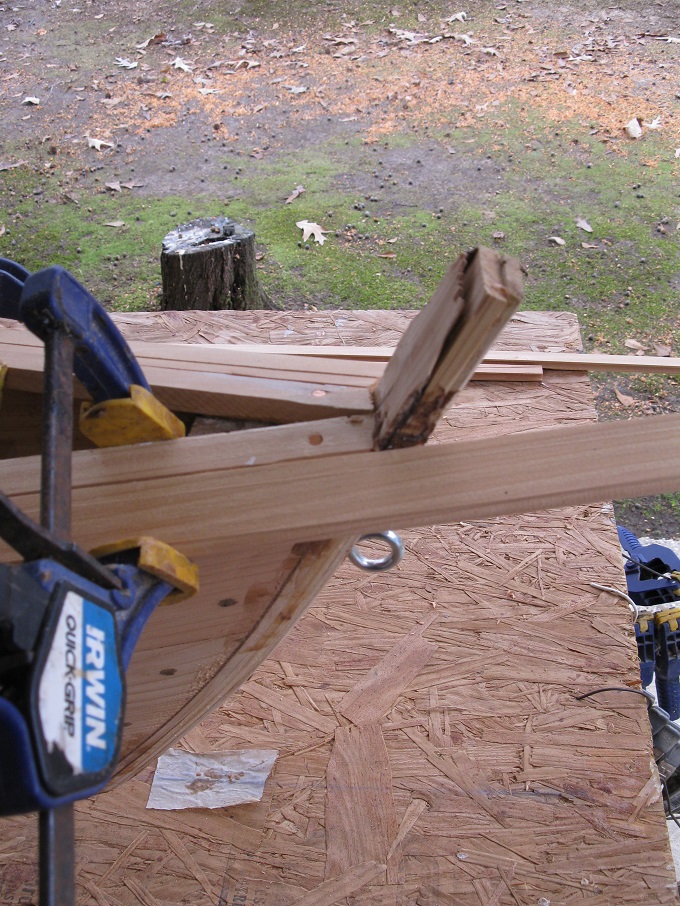

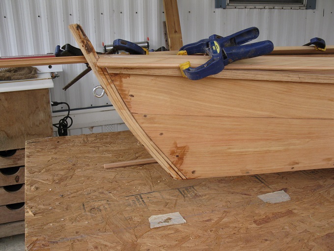

My "work progress." has not been as much as I would like. One mistake I made has had repercussions. I have worked around the problem but it has made progress slower. These pictures show the problem. It is a out of order problem. Does anybody see it?
"Nope. I don't see it."
Jack it's ok. I messed the posting up. It is not possible to see the mistake now because I have worked past it. I struggled installing the strips because I had already attached the batter boards. It would have been much easier with out it. The strips could have been bent and fitted in place and then sawed flush with the stems. Lesson learned, if I don't forget again.
