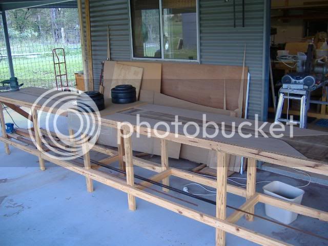

Well I finally got around to starting my Laker 14 last week , I've had the plans for some time but due to other projects lacked , time and space to start ,
Finished up some other projects early last week and cleaned up the shed a bit so had the space to get into it , have needed a new lighter kayak for some time , back is pretty screwed up at these days and the heavier Mill Creek 16.5 is giving me problems ,
Actually the last two time I took it out I put my back out getting it off the rack on the trailer and had to get some one to give me a hand to put it back on and didn't even get to put it in the water ,
When the wife saw what I was building she decided that she wanted one too as she reckons I can't be trusted to behave my self if let out alone so she figured she'd better go with me , don't know how this is going to work out as my wife's idea of a long paddle is about a mile , I said this to her and she just said " deal with it , it's the doctors idea of what you should be paddling any way " , so it looks like I'm going to have a paddling partner
Luckily I followed my usual practice of making panel templates up out of MDF , getting them right then just tacking them on to the rough cut ply and running them round on the router bench so it took bugger all to do another set of panels
Matt , hope you don't mind me doing another one for my wife off the one plan , if you do just send me a PM

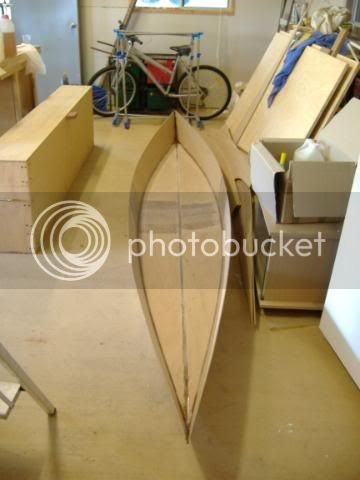

One hull is filleted together and the panels for the other hull are ready to stitch tomorrow , also working on a cabinet to go on the end veranda to take brooms , mops and buckets and such so when I have to wait for epoxy to harden I can go onto some thing else , I plan to make up the two hulls and then set them aside and make up the decks

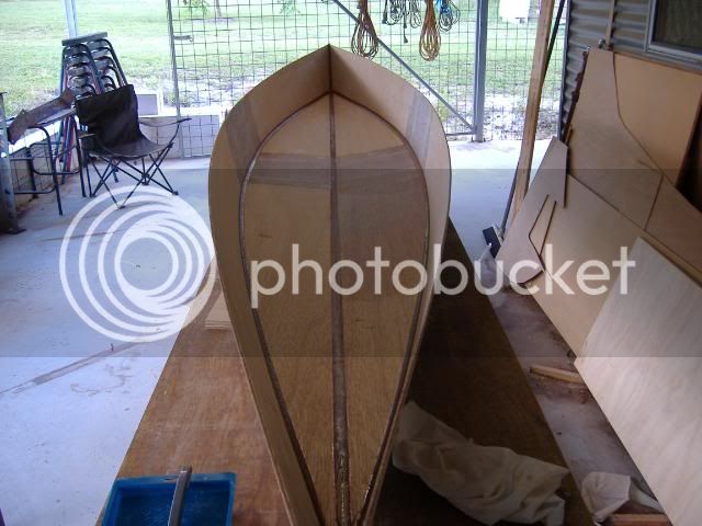

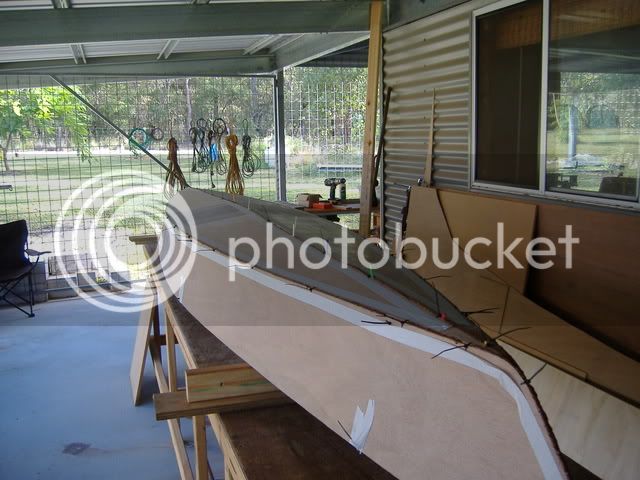

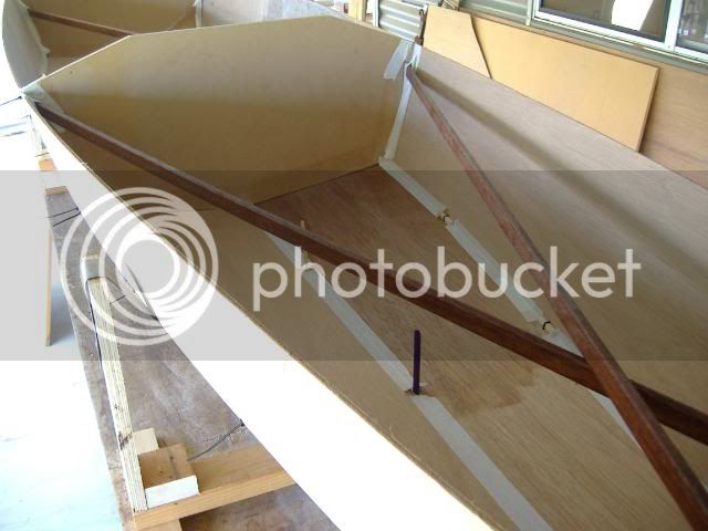

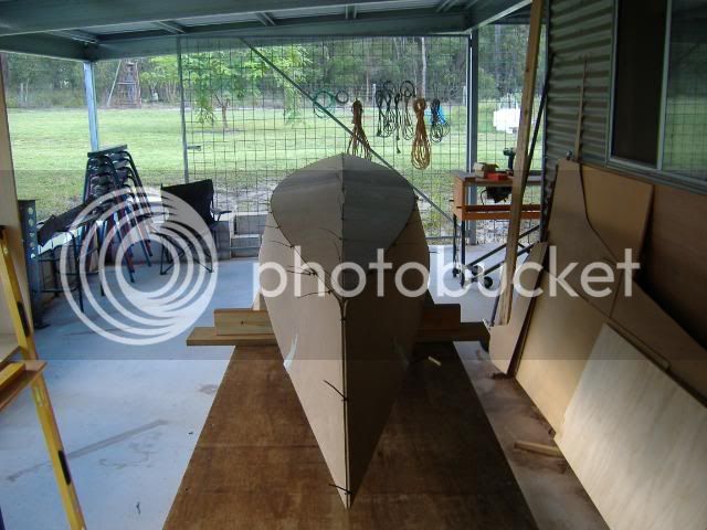

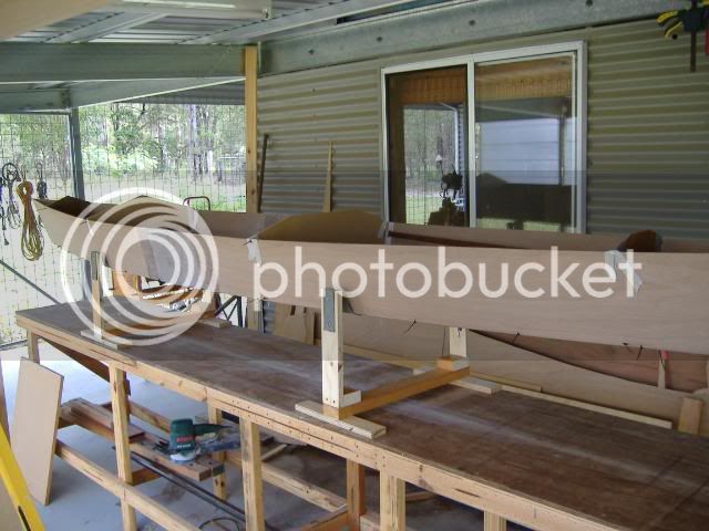

Well I didn't get any thing done on the Lakers yesterday and only a little over 2 hours the day before but I did manage to get it stitched up and the tacking fillets on the outside run early in the morning then run the inside fillets late in the afternoon , got some sanding to do today but not a whole heap , have to work on the new cabinet I'm making so the Laker will take a back seat for a while
I told my cat Boris that when the laker is finished I'd take him for a paddle , as you can see he's beside him self with excitement
gbinga thanks , it's coming on , will need to get around to ordering some foot braces and fibreglass some time this week , at the moment I'm shuffling stuff around to make room to make up some face frames and doors for a cabinet , will need to stack the kayaks aside and maybe get back to them next week

Boris looks....very catlike. [grin] I see ya feel like me. A fella jest caint ever have too much good rope. Now I got a question....bout that wide mesh heavy wire screen. It dont cover the whole porch area. How come? Hmmm....wonder how ya'll say "porch" in Australian? [chuckle]

Yeah , Boris is very cat like , LOL , he only sleeps 22 hours a day , for a cat I think this makes him hyperactive , the other 2 hours he eats , hunts and fights , he's a fair lump of a cat and eats twice as much as the dog and every few nights he goes off and brings back a rabbit or hare , don't know how he does it but he eats the whole bloody thing except for the bowel and the fluffy tail ,
I like cats , they don't hang on you like a dog does , don't get me wrong I like dogs too but dogs tend to be more needy than cats , although Boris is a bit more possessive than a lot of cats , neither Boris or the dog Mischief tend to let me out of their sight for too long , if I'm at the computer Boris is laying on the desk and Mischief is at my feet , if I'm down the shed working both are laying close by watching , although if I go for a walk around the yard Mischief just watches from the veranda , she is 10 years old and reckons that exercise sucks , Boris likes to go for walks with me , strange for a cat
Actually the stuff hanging in the background are my spare extension leads , that is actually a door they are hanging on the back end of the shed is meshed in as security for some of my messier tools like wood lathe , thicknesser , saw bench and router table , I also have my Metalcraft bender setup there , the mesh allows me to just shovel up the mess and then blow the rest out into the yard with a leaf blower , but of a night the whole area where the tools are is locked up for security , I do most of my work out on the covered work area [ 14' x 40 ' ] as it's much cooler and the breeze carries away most of the dust from sanding and such ,
I do agree you can't have too much rope , but I keep mine out of the sun as it tends to destroy it
We do use the word porch but the word veranda is more common
