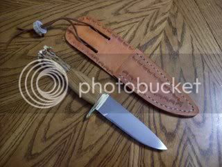

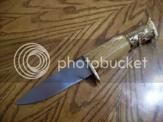

Nice knife too!! show us some "in process" pictures next time you make one.
