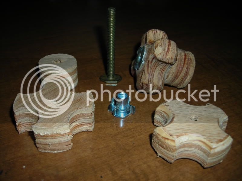

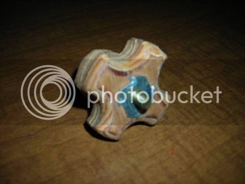

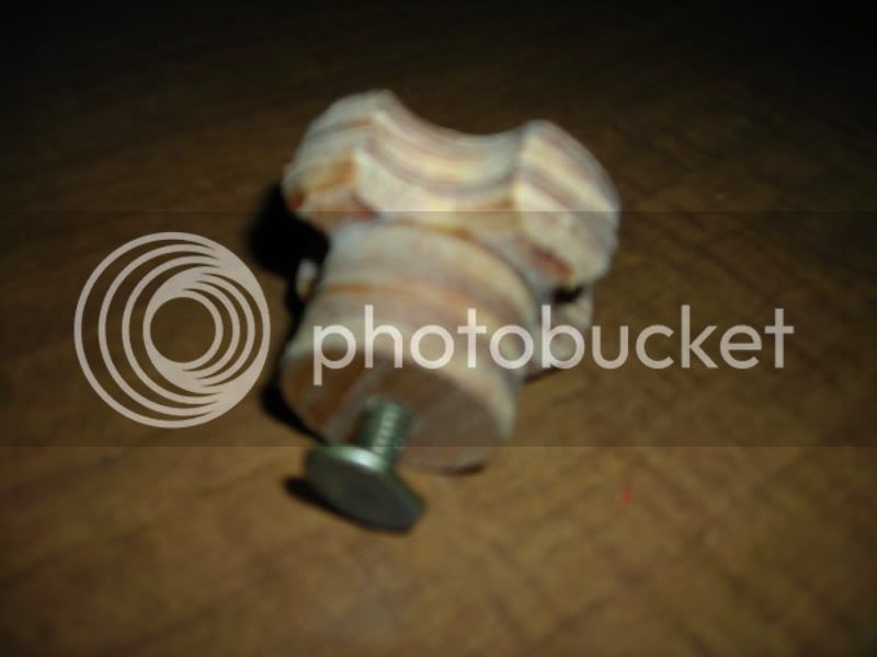

You don't need specialized knobs. You can make your own and that's fun too. It doesn't matter if you buy T track or make your own with wood. A little plywood, T nuts and commode bolts and you are in business. On 3/4 inch plywood use a compass to draw out the size knob you want. On the circle you drew make a smaller circle at 12:00, 3:00, 6:00, and 9:00. You will need to play with these little circles untill you get the spacing right. Use a drill bit the same size as the little circles and drill them out. Use a holesaw the same size as the big circle or use a bandsaw to cut out the big circle. Clamp a Jorgensen type 2 screw wood clamp on one side of the roughed out knob and round over the edges of both sides on a router table. The clamp is to hold on to so you dont round over your fingers. At some point during this drill an appropiate sized hole in the very center of the knob. Insert the T nut in the center hole and hammer it down until it seats against the knob. Use a hole saw to cut out a spacer. Put glue on the spacer and run a bolt through the spacer from the other end,then insert the bolt with spacer into the knob from the other side of the T nut and run the bolt through the T nut and run it up snug to act as a clamp and let the glue dry. Back the commode bolt out a little and insert into the T track.

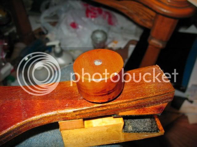

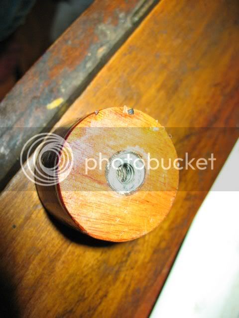

I did something similar on my removable portage yoke. Instead of using T-nuts, I epoxied in a regular nut and put it to the bottom where it doesn't show. I also didn't put in finger grooves, but the knob is large enough to get a good grip on as it is.
