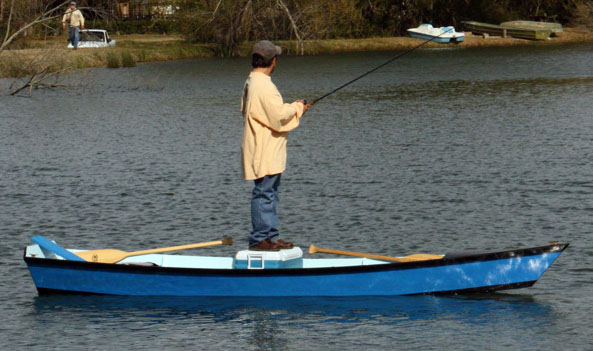

The question came up a while back about the stability of the Bayou Skiff , here is Jason fishing out of the one he and Uncle John made.
By the way , Jason said he weighs in at 180. Using canoe paddles this time in place of the oars , he stored the paddles behind the seat railing running down the side of the skiff. The blue board you see at the transom is the middle seat , it is removable.

Thats what I've been wanting to see. Any word on how comfortable he was standing up on the cooler. As that is what I will be doing but a little closer to the rear of the boat so I can pole the flats. I am also going to keep the width of the widest rib all the way to the transom to help offset standing closer to the rear. I just still working with scale models to try and find a way way to remove mosst if not all rocker but still keep the 20-25 degree angle of the ribs and the 30-45 degree of the stem. Any thoughts would also be appreciated.

No idea about the comfort factor but he does look comfortable.
Not sure about what you want to do , it will take someone more knowledgeable on that then me , I just make them as designed.

Sorry I should have elaborated on the whole comfort thing. What I should have said is how tippy was it and could he move around much at all or did he have to be purty careful while up there. The big reason I want the rocker out is so I dont windmill when I'm by myself. I plan on putting runners on the bottom, but the more I have in the water length wise and not depth the better. Cause I will be in shallow flats.

I'm waiting on Kayak Jack's comments. :) I got called out for my "inadequate" PFD and I was wearing it standing on solid ground, not perched on a makeshift deck. This ought to take the heat off me. :lol:

I have to guess he is fairly comfy up there, because I don't see any little "wiggle wakes" like you can see in this photo of the first time I stood up in my skiff.
I am a lot more comfortable now, but you can see what I mean.

<snip> Did he catch anything? If I hooked into a fish i think i would forget about balance.... :D
You're slower than me, Jammy. I wouldn't have to wait nearly that long. I'd be overboard before I got the second foot up on top of that cooler. And probably spill all that lovely beer in the process. :(
