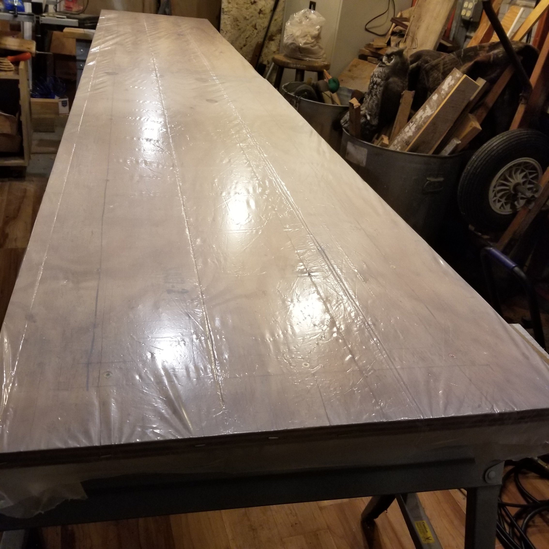

Well it isn't much to look at but the table is built. Ended up leaving about 2 inches of plywood over hang of the 2 x 4 frame. Countersunk all the screws on top to keep it smooth. Ended up being a smidge over 11 feet since I had used a piece off of the sheet I had. Wrapped the whole thing with 2 mil plastic sheeting. MAY start laying the plans out tonight.

OK, 3C, now you’re ready to start to work. BTW, a piece of waxed paper will serve to preventgluing your blat to your workbench in smaller areas.
i see your round, metal washtubs alongside the bench.That’s what I took a bath in as a kid.

I know the tubs you speak of, but those are actually galvanized trashcans only one of which is used for trash unless you ask my wife. She thinks they are both trash. The other holds small scraps of wood until I deem they are no longer usable. Most of what is visible in there is old cypress off of a torn down house. I used it to make rustic looking barn style closet doors, a bed, and night stands. Just can't part with those pieces yet since some would look great on the deck of this kayak! SS&G style, because why not make my first build harder?! Build thread to follow soon.

Well, I never took a bath in a trash can, even in Nam. And, I admire your love of the wood.
