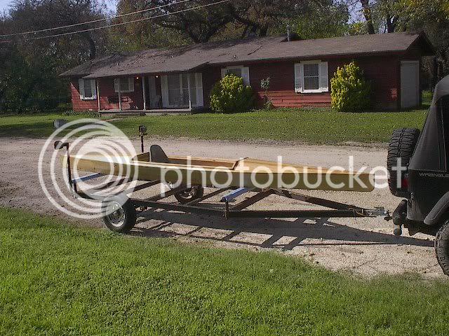

The duck is not finished but i couldnt wait any longer. I loaded her up and headed for the lake.
I was by myself so ya'll will have to wait for paddling pic.

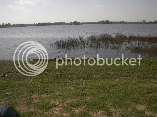

This is a short summary of the ducks first outing.
I took a lot of chances on this boat,and invested a lot of time and energy not knowing if it was going to work out. The striper s@g was the first one. I have to say I really like this way of constructing a boat,benefits of the S@G and the versatility of the stripers.
Second thing ,this was the narrowest boat I had built,20 inches at the bottom and I wasn't sure
if I was good enough to handle that and how stable she would be.
Third chance was a full 16 ft water line ,I didnt know if I was a good enough engine and I didnt know if I could heel her being that narrow.
I unloaded her threw a seat in and got in,hum that wasn't bad,backed her out from the bank nd turned her,didnt turn to bad
I started paddling out toward the open lake,and started hitting the swells and small white caps,three strokes I glanced at the reeds and they were flying by ,I was grinning from ear to ear.
I turned her sideways to the wind and waves and let her ride for a minute ,no problem paddled back to get the gps. as I came up to the bank I heeled her over till water came over the side,not the coaming,she turned like a dream.
I started back out into the lake and it was getting rougher, she is long enough to handle some serious waves without taking on water. I hit three are four hard licks with the paddle and then sat back ,the glide was awesome straight and long even into the waves,now my seat is loose no footpegs so basicly I am just arm paddling ,I started setting down on the paddle and watching the gps ,now I am fighting wind and waves. the gps started climbing and at 6.5 miles an hour I just sat back and laughed. turned around and paddled with the wind back to the launch.laughing all the way.

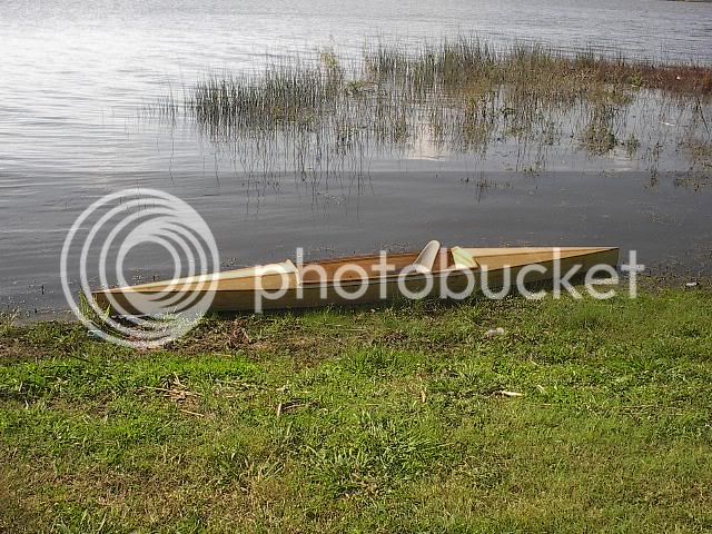

Couple more pics.
The last thing I was worried about was as narrow as she was might sit to deep in the water but with the long water line I think she floats just a shallow as the Cuda.
Needless to say I am tickled pink ,she will heel,fast good glide and so easy to get up to cruise
plenty stable, with decks now wind effect at all no weather cocking.
I LOVE THIS BOAT
Now I need to go put in the pegs put a finish on her put on graphite bottom,so I still have a lot to do.A very happy Ron
