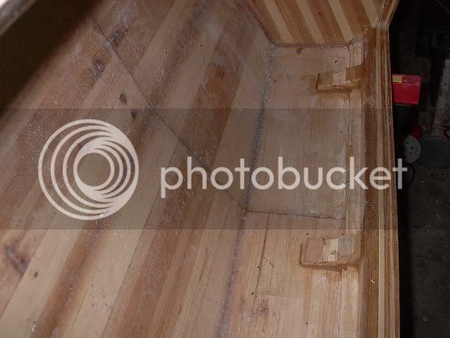

Had a chance to do a little to the duck today. I cut and glued in blocks to mount my sea dogs on.
When I cut the blocks out I beveled them so the pegs were close to straight up and down. I cut a grove for the screw head to clear. You can see the single screw for thrue the hull mounting.

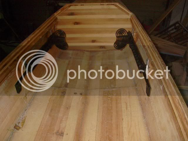

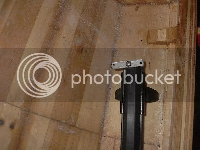

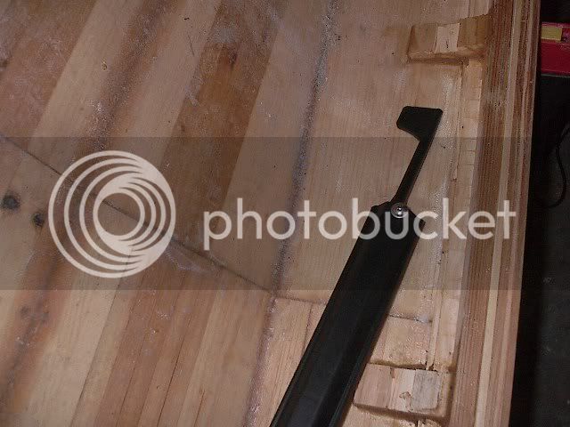

I then made some aluminium brackes that bolted to the thrue the hull mounting brackets and could be screwed down to the blocks
And this is what I wound up with
Before I run any glass over them I am going to try them out and see if everything is the way I want them,then I will go back in sand and glass.
