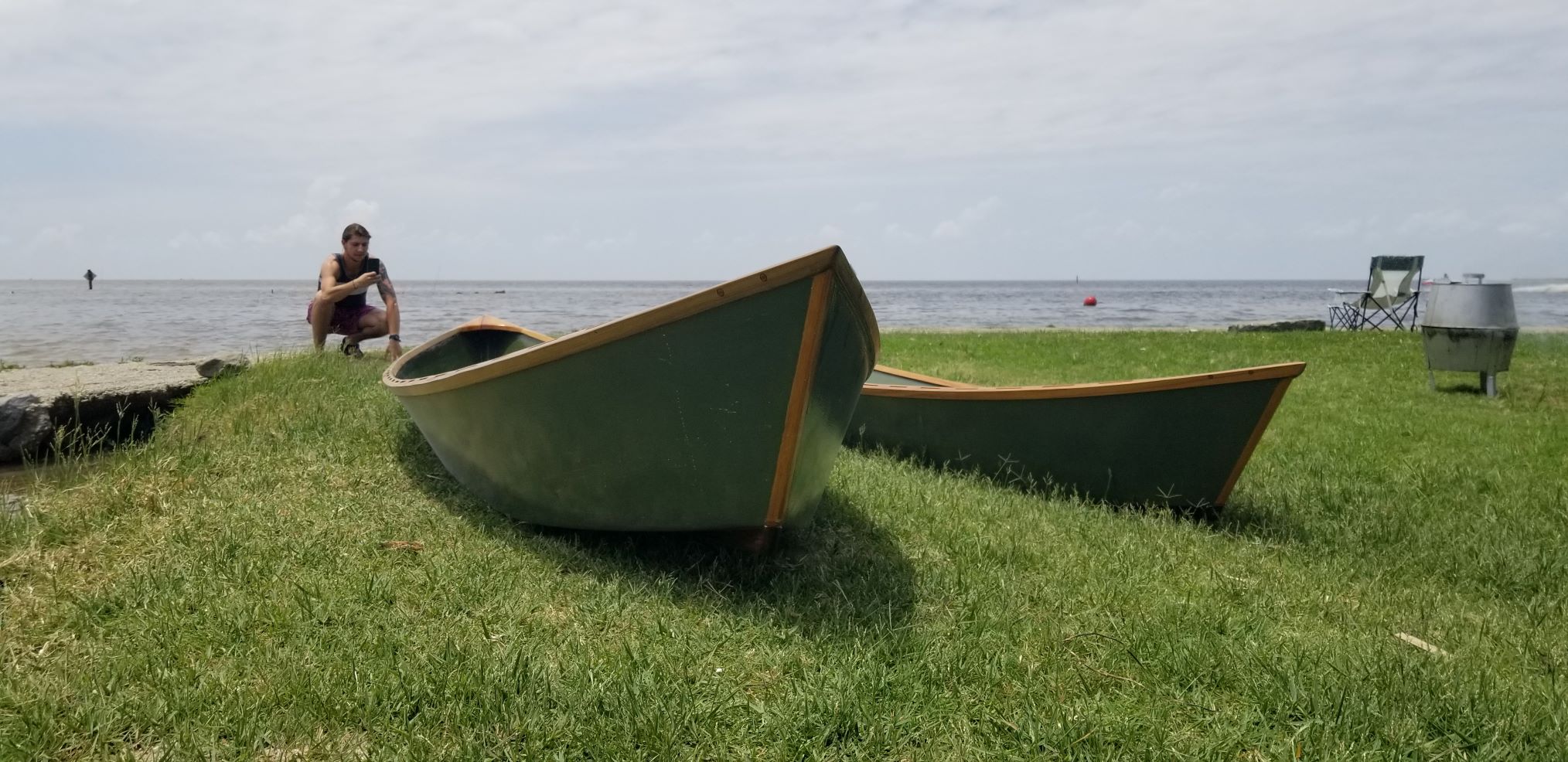

My name is George and I've recently joined this forum to get advice and suggestions on my next build. My friend and I built a couple of pirogues in Lafayette using the "Cajun Secret" plans and would now like to build a slightly wider and longer boat with a flat back transom to accommodate an electric or small gas motor. We've learned quite a bit through the construction of the 'rogues and through the numerous sea trials so we have a rough idea of what we want to build. I've also purchased Uncle John's wooden Jon boat plans as supplemental advice.
