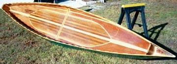

The JEM Swamp Girl is the widest of the three boats and offers the most stability , especially for standing while fishing. Making the Swamp Girl is a little more involved but not a lot. It is basically a wider pirogue that was designed for backwaters and fishing.
It requires three sheets of plywood for the 16 foot model. I made the 1st one and used it for fishing , camping and river running , it is very stable and an easy boat to fish from.

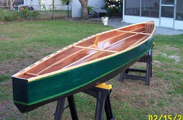

It is a custom design I requested from Matt and after e-mails and working on how it should be he came up with the plans to make it. Here is a picture of the Swamp Girl on a camping and fishing trip I took.

I sent the pictures to Matt to use on his web site after it was made.
I squared off the stern so a trolling motor could be used , if I wanted to have one on there.
I made it out of 1/8th inch wood so the bottom was built up with 1 inch wide by 1/8th inch thick strips of left over wood to strengthen it.

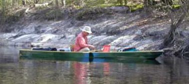

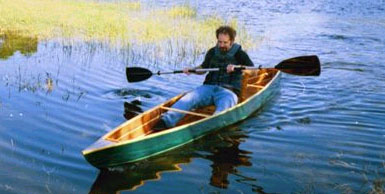

My neighbor trying it so I could take a picture of it being paddled.
I've always said standing in a boat is 40% boat and 60% the person's sense of balance.

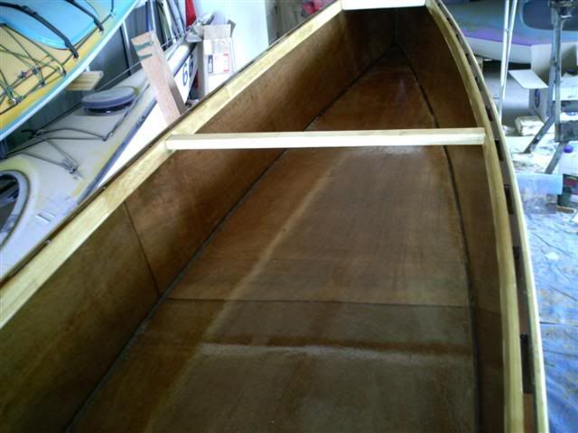

Mate, For the ply on my touring pirogue, I simply bought 2 sheets of 4mm exterior bracing ply from bunnings. Its a little heavier than Gaboon or even Luan but I think its a good compromise at a reasonable price.

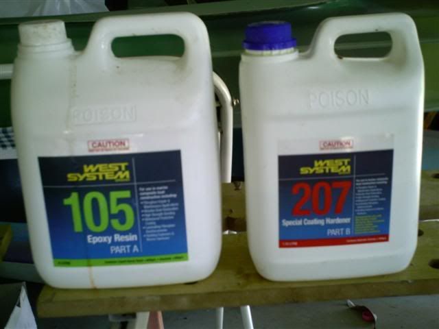

Re the epoxy, I use only West Systems Epoxy that I get from ATL COMPOSITES at http://www.atlcomposites.com/distributors/index.htm Ph no. 75563122 Ask for Scott Alexander

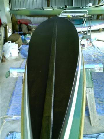

Mate, the finish was superb. I gave the ply a lite sand then saturated with epoxy before I styarted to fibre-glass and It came up a treat. Prior to epoxy, it was a "c" finish ply and a pretty ordinary "C" grade at that.
Yeah My pirogue had a flat bottom and I put a small keel along the centre line. Reduced maneuverablility a bit but tracked very well. :D
