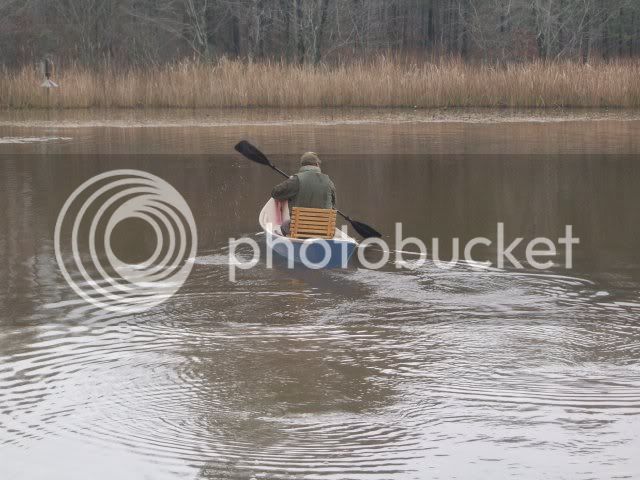

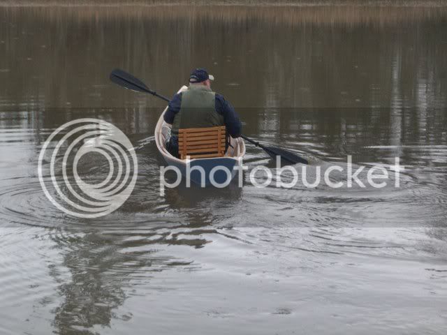

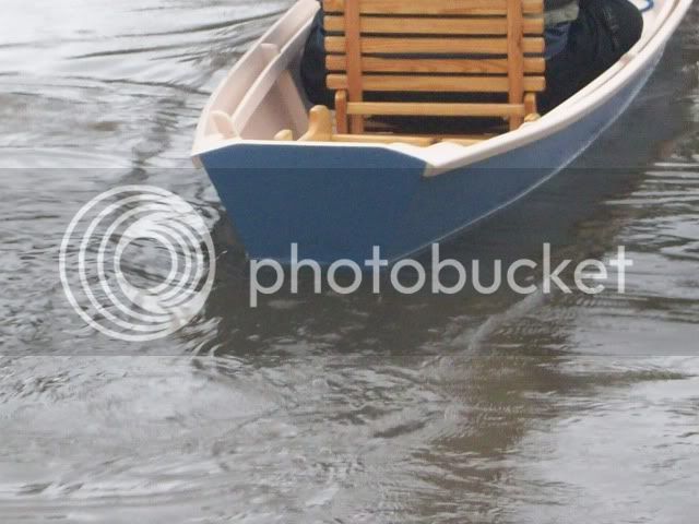

The turbulence at the square stern causes water to be actually pulled along with the boat rather than smoothly turning it loose as in a pointed stern boat.
Watched my son paddling my skiff. I could see the turbulence behind the stern. Looked as if the water was rolling up the transom. Thanks again for your and Kayak's input.
1,912
The turbulence at the square stern causes water to be actually pulled along with the boat rather than smoothly turning it loose as in a pointed stern boat. Might not be noticed much at 2mph but starts to come into play at about 3 mph. I've seen resistance charts online for all types of paddle craft and there is VERY little difference among them at around 2mph. For every quarter or one half mph above that, you start having to make significant changes in design. Narrower and longer is what does it. Almost no getting around it. :( Probably narrower with sharper ends gives the most bang for the buck. You can't fool physics.
Thought I would post these pictures. May illustrate what you said. I believe I now understand. I don't know if this is a lot of turbulence or a little. It is probably more than a pointed stern would have. It is my sons "Christmas Present" boat, my attempt to improve my "firewood" skiff. I don't have any pictures of it's turbulence, but visually it is more. I also know his is easier (faster) to paddle. Thanks for posting. You helped me build a better boat.
2,326
