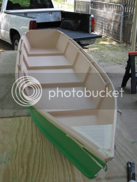

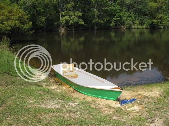

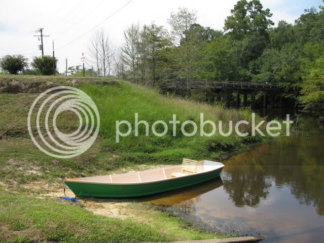

I have been busy trying to finish the boat (lots of fun). It does not leak and paddles much better than my Croc. Only had it out one time, but that was enough to know it won't be firewood any time soon. Thanks for your advice and many answers. First trip pictures:

That really is a great looking boat.
My God but ya'll have some great looking water to boat and fish in out there. Get somebody to remove the snakes and I might move!

I built it as a fishing boat. I'm not an experienced paddler, so I have no idea how it compares to other boats. more paddle time will help me learn the boat and how best to paddle it. I tried different seat locations and heights, but came to no conclusions. I did learn you have to paddle slooow to fish. Kept gliding past the spots I wanted to cast to. A paddling question; Why does the boat seem to always turn to the right after I stop paddling? It glides straight and then drifts to the right as it stops. Did not seem to be a wind or current issue.
Keith and seedtick did answer a lot of questions about boat design and my needs. After trying seedtick's Dad's bateau and really liking it, He suggested I could build it as a skiff. Used the ideas we talked about and my U.J. Pirogue plans(as a step guide) to build my skiff.
