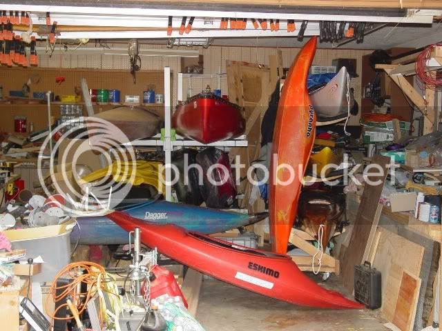

I counted 8 , might be 9 (Not sure) plastic and ONLY two wood boats in this picture .... For shame , for shame , I will hang my head low and never look at the sky again. I was sure we taught you better then that. :oops:
That would be three wood boats with your new build which you are secreting away from us so we don't become to envious of your building skills. :D
Don't worry you can show it on here , we will just rake you over the coals later when you post a trip report when paddling it. Ya know like asking where you bought it , who built it , do they make more of them. Are you really going to get it wet or is that picture from Photo Shop ?
