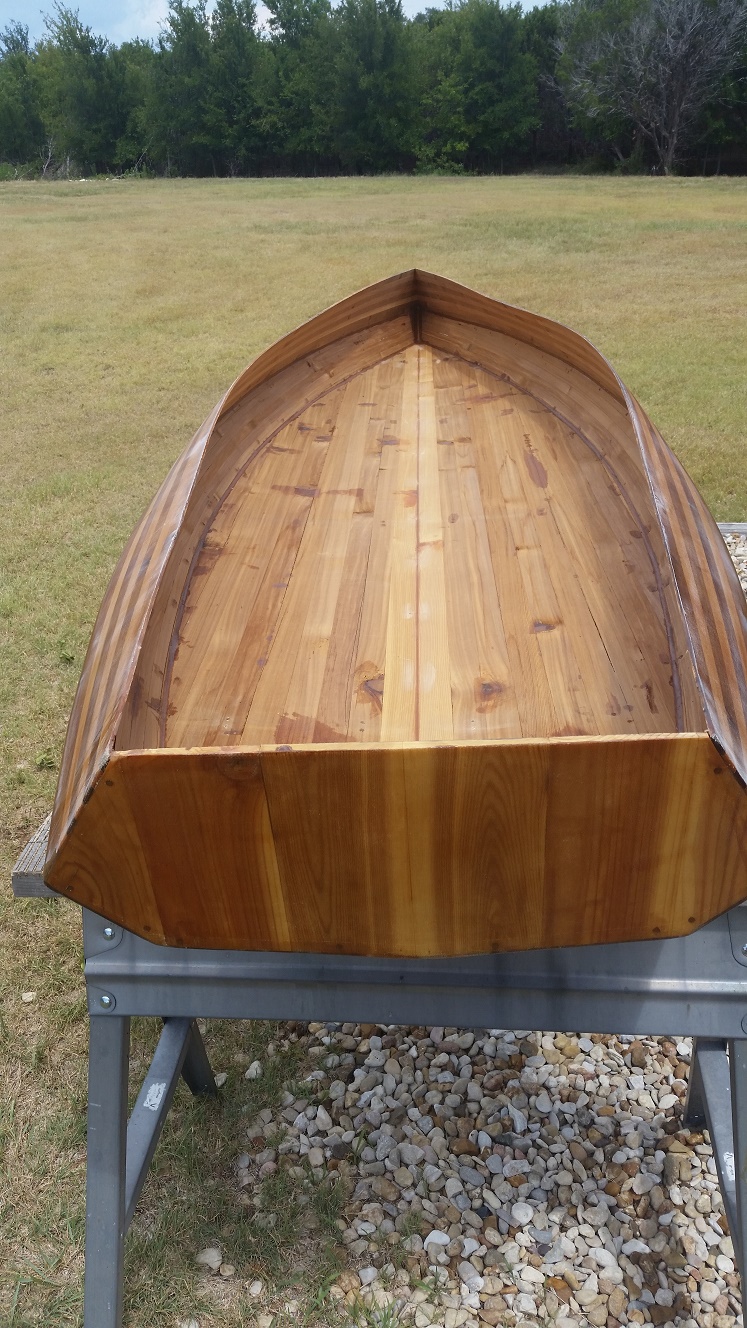

Guess I might as well pass on my experience and give you something to read. Sometime ago I glued a stripped deck and glassed on side to get ahead of the game. A few weeks later pulled it out of the shed to find it had warped so bad it wasn,t useable. About a month ago I had a good start on a pirogue. Glassed the outside, and had to quit because of some medical issues. Pulled it out today to start the inside, the tops of the sides are warped, and it is no longer perfectly square. All recoverable but will be added work. My thoughts are if you glass one side, don't wait too long to do the other side. It's more warped then the picture shows.
Andy, sorry to hear of the bad experience. Was the non-glassed side epoxified? A saturation coat may(?) have slowed or prevented absorption of humidity?
