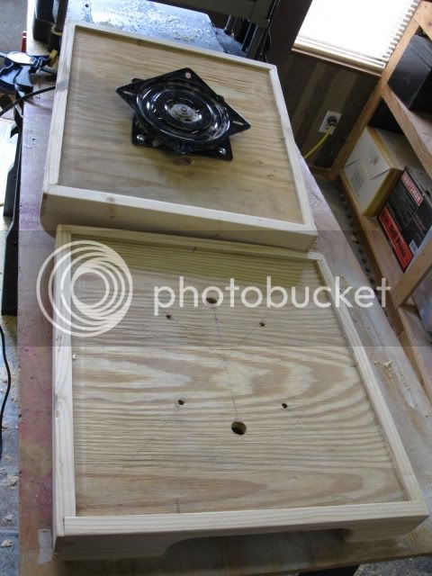

The seats are beekeepers handicraft and I do like the idea of the swivel base , would drill a drain hole in the flat part in case of rain. This way the water would not back up and get into the bearings in the swivel portion.
The two large holes shown in the first pictures should drain the water. They also allowed acess to the bolts for assembly. Hope this is a better view:
Weight conscious builders will not like this base. The swivel and plywood add weight. A light weight swivel and less wood in the base is needed. Time and use in the real world will dictate the changes needed.

An idea for a lighter and more waterproof and perhaps even better performing swivel base.
People who make large (ones that look like massive mortar tubes) homemade telescopes called Dobsonians solved the swivel problem years ago. They use a flat sheet of formica on one surface, and on the other they have 3 pads of teflon. They also have a center bolt, but thats just to define the center of rotation and to keep the top from coming up off the bottom.
Some types of formica are better than others, but they all work pretty well. The teflon can be a pain because you can't really use anything to glue it to something else. You have to use mechanical fasteners, so the teflon has to be thick enough so that you can countersink your screws or nails, otherwise you tear the hell out of the formica in short order.
You can adjust the amount of effort it takes to turn it by adjusting the pad sizes and how close or far away they are from the center bolt.
The nice thing about this method is the friction is low enough that its easy to overcome, but its not so low that your things spin freely. Once you stop rotating, things pretty much stay put. And the stopping, starting action is NOT jerky, because unlike most other bearing methods/surfaces, the effort to keep it in motion is GREATER than the effort to get it started, so you don't get that push hard then break loose and move easy action you get with so many types of mechanical widgets. When done right, you'd swear you had thousand dollar bearings in there instead of something so cheap and simple.
You HAVE to use REAL formica and REAL teflon though. There is stuff out there that looks like both, but it isnt and doesnt work nearly as well. Do an internet search for telescope making supplies/teflon and you can probably find some. If you don't want to buy a giant sheet of formica, hardware and cabinet/countertop places often have scrapes for cheap.
Just an idea.

Thanks for clearing that up , they were not visible in the picture with the seat on the swivel base. I'm not worried about the weight since I intend to have the skiff on a trailer. Plan on getting it from Harbor Freight , the one they have for boats 14 feet and shorter. As far as boat trailers go ( around here ) it is inexpensive at $329.00

Thank you for the teflon idea. The telescopes don't look very heavy. I wonder how it will work with the weight of a person? Probably have to build one to know. May be some other "outside the box" uses for teflon for our boats.
This site has teflon and other supplies; http://www.mcmaster.com/#

I've seen it used on telescopes that weigh much more than a person does, so its certainly workable. Do keep in mind that it is low, but smooth friction. If you want to swivel with extreme easy (very low friction), a lazy susan type bearing as discussed here is still going to be better. But, on the other hand, a lazy susan bearing won't "lock" into place like a teflon/formica system would. So which is better would depend somewhat on circumstances and personal preference.
Something obvious, at least in hindsight. You want your formica surface to be the downward facing surface and the teflon pads to be the upward facing surface. If you do the opposite, the formica surface becomes a nice place for sand/grit/gunk to accumulate and embedd on the teflon and mess up the formica.

Thanks for the additional thoughts about the teflon swivels. I only looked at one telescope in my search. It was made from cardboard. My ignorance shows again.

Teflon disks are also used in lieu of grease on 5th wheel trailer hitches. I don't know if they would work for a seat, but you can see one HERE.
