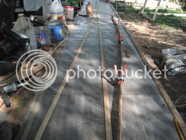

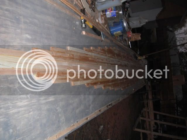

I got started today and cut some strips and started laying out the center panel.
The boat will be a combo of western red ceder and white pine.

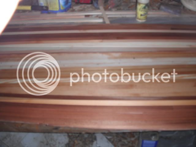

Got the bottom panel glued up.
And we are off to the races.
Got a little more done

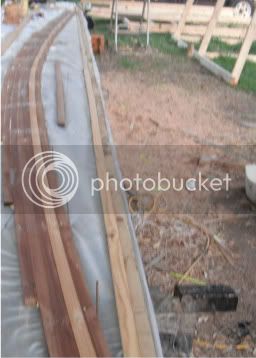

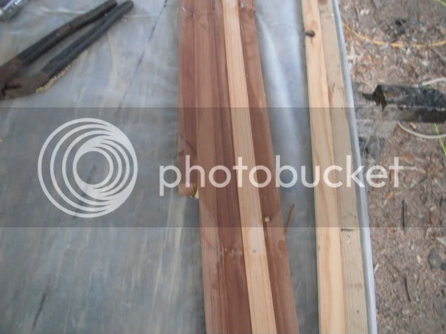

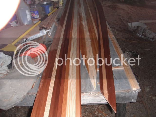

Both risers striped and glued
Those dudes have some curve to them
I believe this is the straightest grain cedar I have ever used
Nice color and there is even some black in the grain,should look good with glass over it.

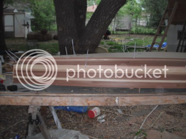

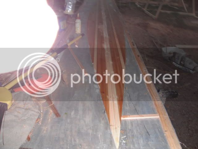

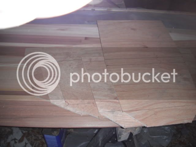

I didnt post yesterday but I got the side panels glued up.
Today I laid out and cut the bulkheads

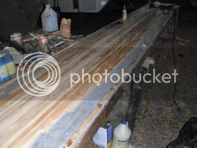

Then cranked the ole planer up and ran the panels, I made the bottom in 2 panels so I glued it back together , turned out good.
the wood in this boat is great looking
here is a couple pics of the riser panels and the side panels
Dang I dont know if I want to let this boat go :lol:
PS I did wet these panels down to look at the color so for they havent melted

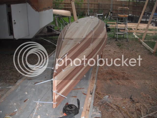

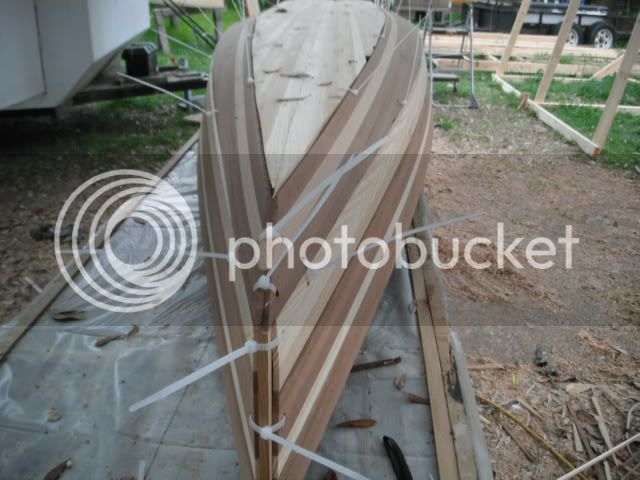

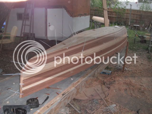

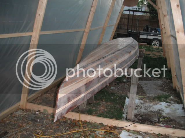

Got a few minutes to play with the Lady bug . I started stitching her up and now she is starting to look like a boat
I would have run some filets but it was to cold, tomorrow it is suppose to warm up
This boat is going together really fast
After taking off for a few days , dang Texas weather, I got back on the bug, got the outside filets run and then sanded her down smooth again
Ole boat is taking shape

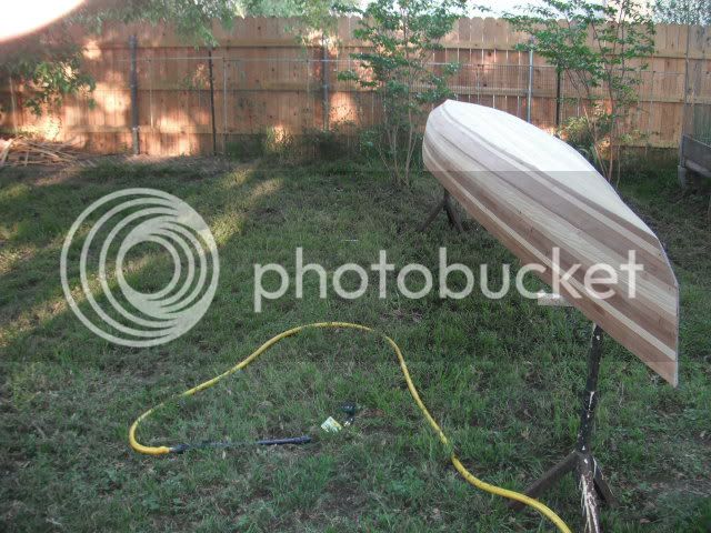

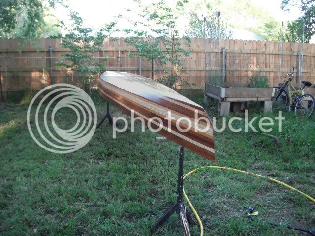

Finished sanding and wet her down.
not sure if I want to sell this boat ( Kidding Ricky)
I will do what ever you want but if I was going to keep this boat there would be no graphite on the bottom it is just to pretty.

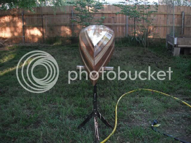

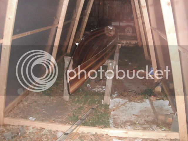

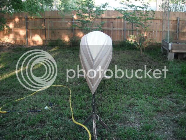

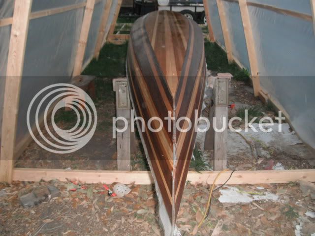

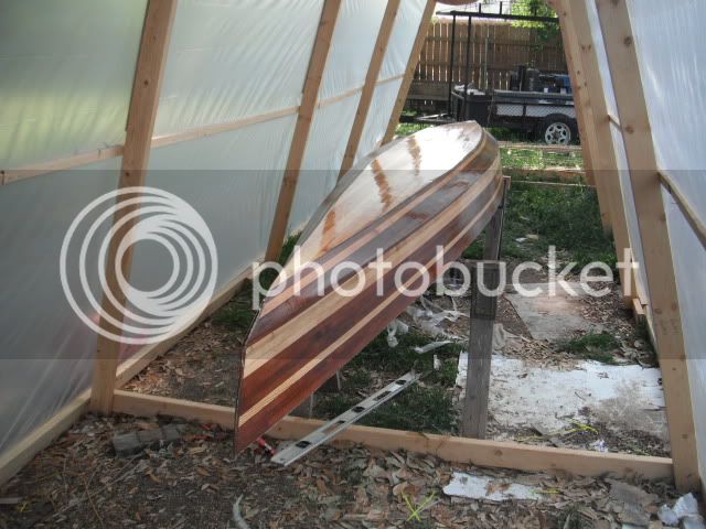

Cut and laid the cloth on the hull , I let it sit an hour or so rubbing out the wrinkles a few times.
Then on with the epoxy , I am still amazed at how it clears and the wood shows trough.
To Tell the truth I hate to get rid of her , I think she is going to be my prettiest boat so far.

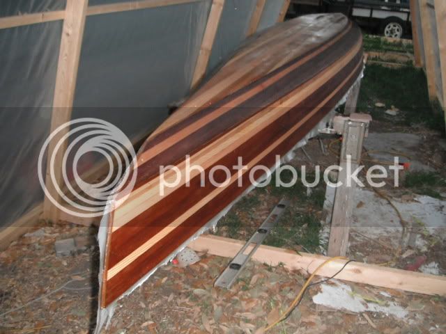

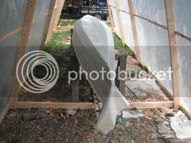

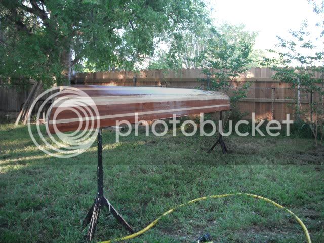

Yesterday I didnt post but here is what I accomplished , fill coat applied
and glass trimed
She is starting to get a little shine now.

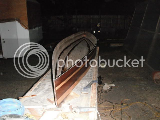

Today I flipped her over removed the forms and applied the filets and end pours.
Got the filets cleaned up and glass put on most of the inside.
I am doing the glass in several pieces, they call it the safari lay up , you double lap the glass in the area of the cockpit that gets the most strain and it acts like another rib in the boat.
