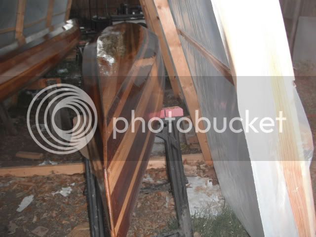

It is a love hate relationship with the epoxy, I hate how slow it dries , hate using it for filets, I would have been through with this boat using poly.
Love the finish you get with it ,and the fact you can take it easy because it goes off so slow.
Hate having to let a boat sit for a few days for the epoxy to cure.
I guess it is about even up :lol:
I do think it is softer than poly

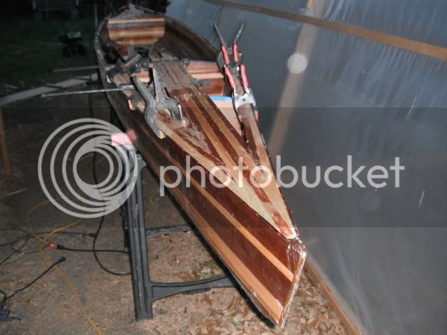

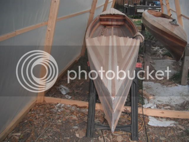

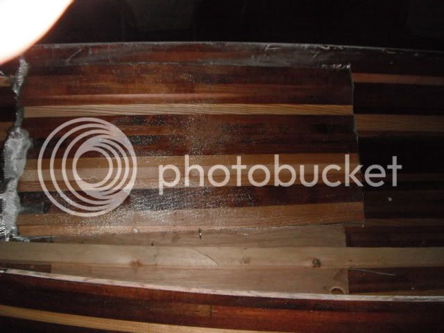

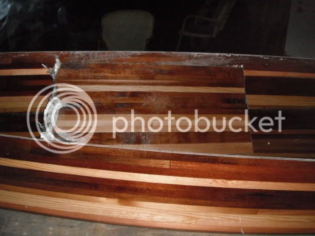

Got the bulkheads laid up and glassed
Think they are going to blend pretty well
Yep have the Northwind in there right now.

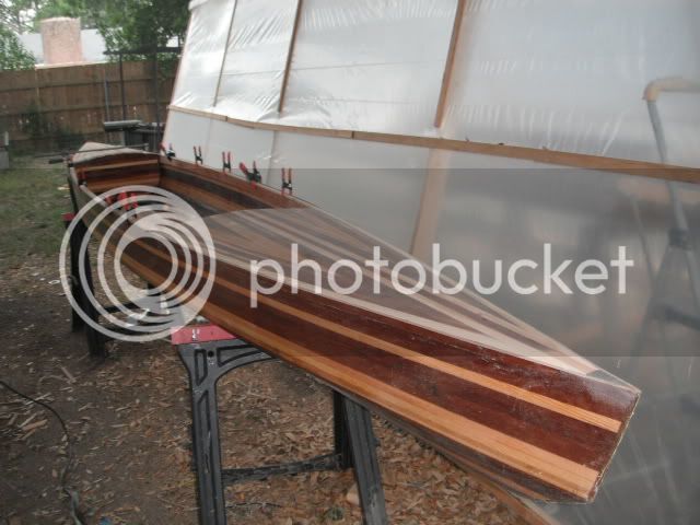

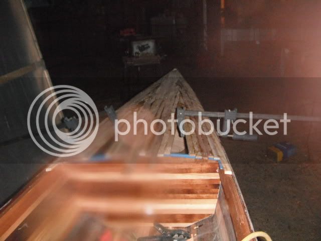

Got most of the decks striped today ,
about one more hour and they will be glued up.

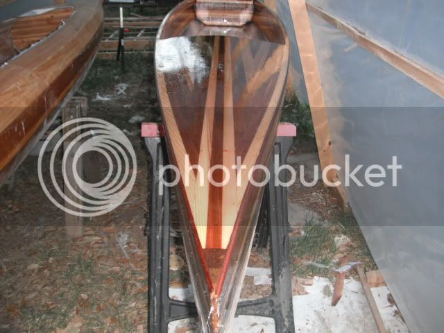

Finally got the decks striped out and sanded
I am like this .

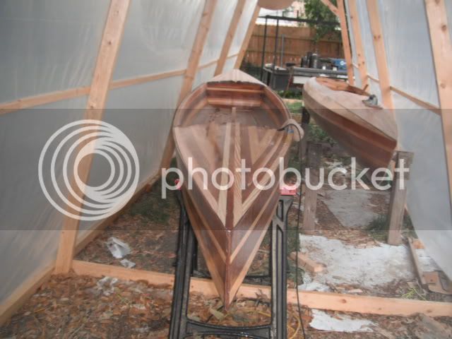

Wet the decks down for a preview of the look.
Oh yea now I am getting pumped over this rig.

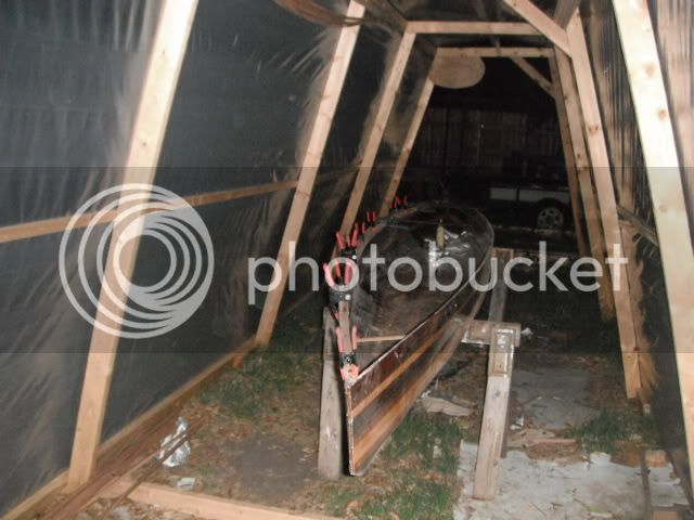

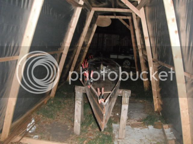

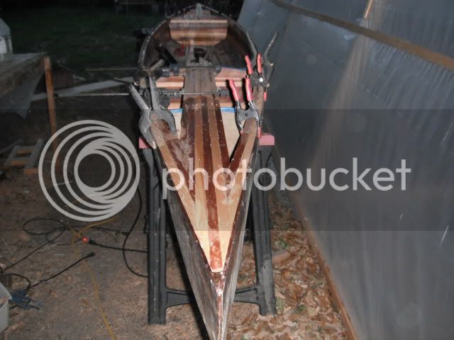

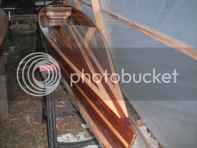

Decks glued down ,
Gunnels from white pine glued on
This should take care of the structural part now she will start getting dolled up and looking good.

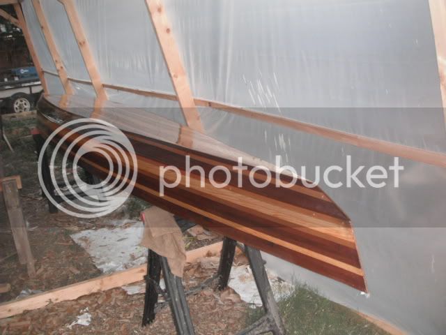

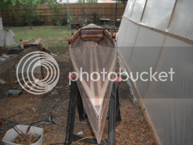

Getting some fill coats on her

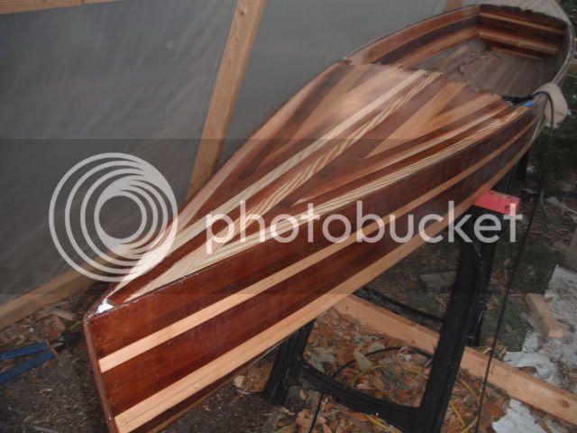

She is starting to get that finish I want now,put the cloth reinforcements on the bow and stern
Slick it up a little more and then shoot the varnish on her , should shine like a new penny.

Well I have the boat back to finish now.
After the boat show (eye Candy post) Ricky and Stacie carried the boat with them for a long weekend on a local river. The boat wasnt finished but was usable.
They put a few miles on her and even got it slimed.
They also tried a passenger and it handled it fine
Little view of how she handles
Well I have her back now and it is time to doll her up.
