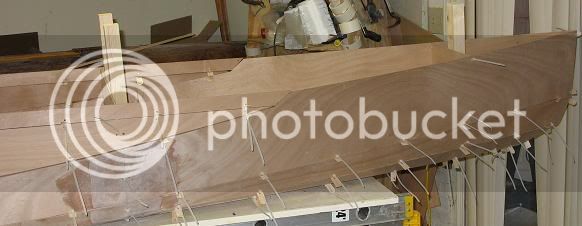

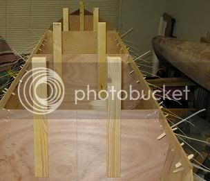

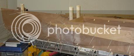

Tried to get a shot of the whole boat. Not easy when it's 17'.
Bow
Stern
End view

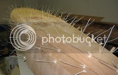

Holy porkupine Batman!
Time for tack-welding.

still looking at the pictures, Whats going on at the gunnels in the area were it is pinched down? Looks like a second strip of wood at the gunnels? Temporary or another bend right at the top? Again, looking good! I can already see myself in it on a 2 week trip down the Suwannee!
Brad
thanks.
The tumblehome in is 2 parts. The part that angles back into the middle of the hull and then a straight 90 piece at the top.
I had concern of how I was going to install the gunwales to the "facet tumblehome". I added the 90 piece to help address that.
Looking at it tonight, I believe the hull wood will bend just fine to accept a gunwale. So adding that 90 degree piece should pay off.
Started tack welding the center seam.
Already picked out a couple minor tweaks I'll do to make assembly easier.
Yea it's a lot of zip ties! :lol: I buy them in bulk so there's only about $5 there.
