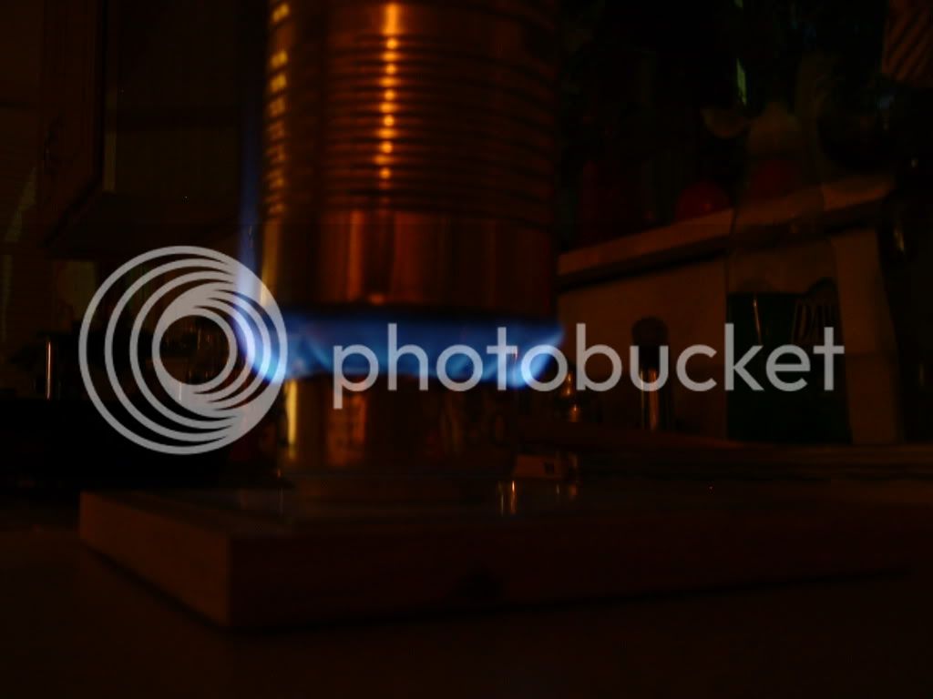

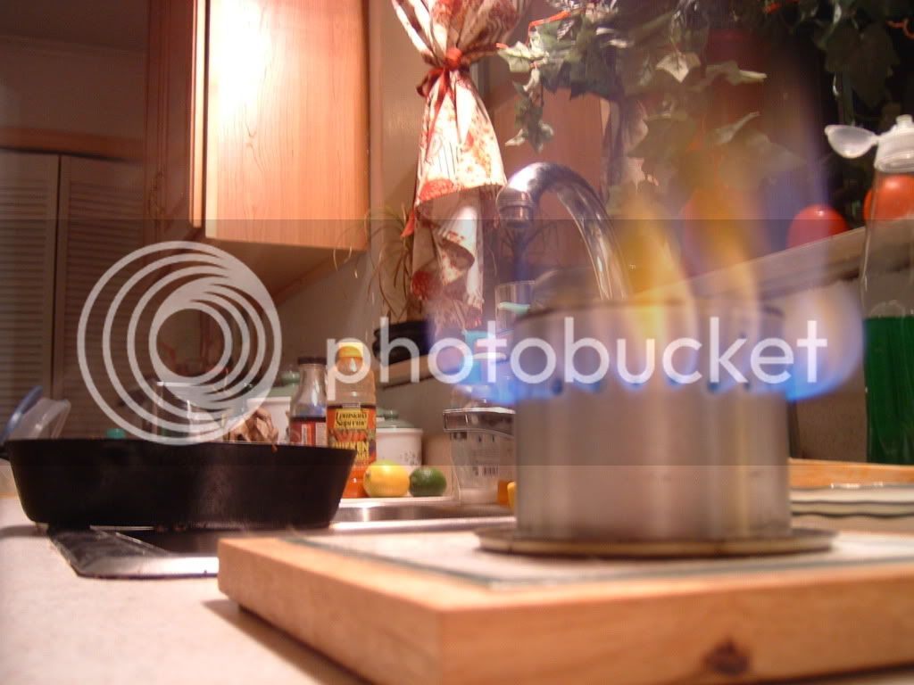

Here is a new stove i made yesterday. Real quick and easy design, just two pieces of metal and some holes. Start with one of those new aluminum beer bottles. Cut off the bottom....and most of the long-neck, then just below the "shoulder" of the bottle and there you go.
Here it is warming up. It "starts" quicker than any pop can stove i have ever made.
And, really cookin'
It fits in my big soup can pot. This one's a keeper. Lots stronger than pop cans, can hold the dutch oven with food in it, i'm sure.
