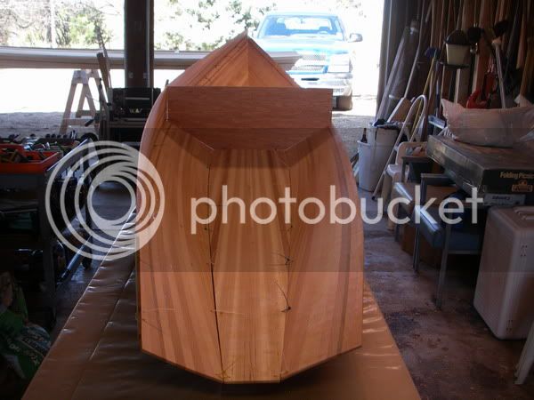

olecajun, That design is the Toto by Jim Michalak, alway liked the look of this hull, do not expect high performance though, short waterline and pretty wide. The strips were all edge glued flat on the bench [[img]http://i469.photobucket.com/a...end/The Toto build/IMGP3274_resize.jpg[/img]]

makenmend said:
<SNIP> Then assembled stitch and glue mode, [url
][/url]
It never ceases to amaze my, how a pile of sticks or a pile of plywood can be transformed into such beautiful shapes, be so pretty, and provide so much fun for us.
